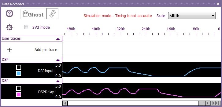

Here is the working delay example.
Delay.fcfx
(16.26 KiB) Downloaded 842 times
The data recorder window is great for visualising the DSP data and seeing what is happening in the chain.

I played about and made a simple Lo Pass Filter, works well in sim and monitoring through the data recorder.
Got my head around the basics of linking the DSP components. So far..it certainly seems a cleaner approach, without setting ticks etc.
