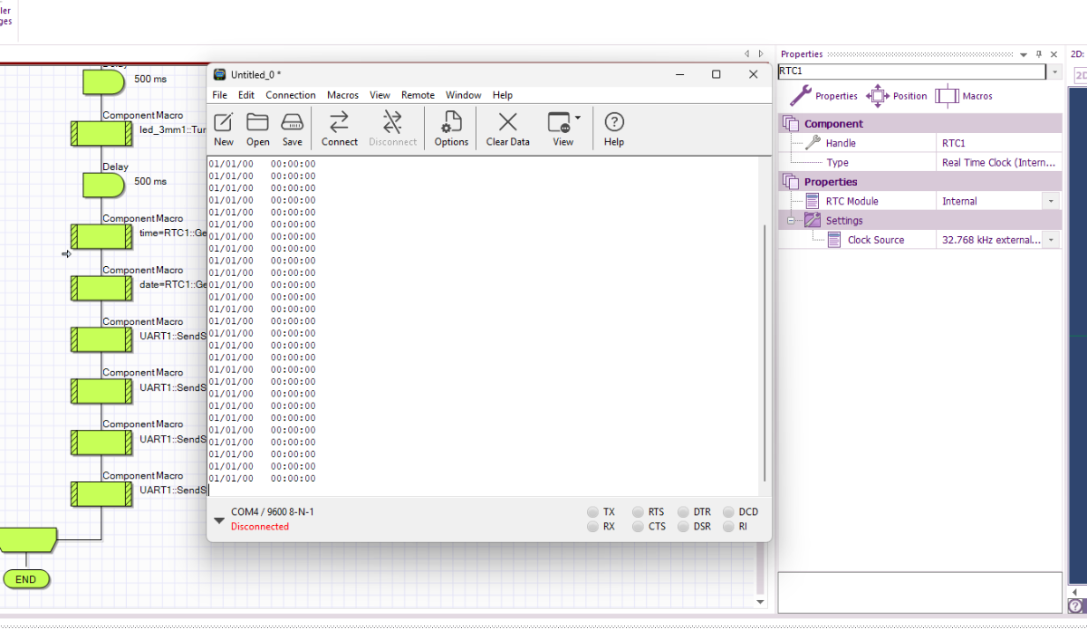

I tried the internal component but it behaves strangely, I made a small preogram to test it and if at the beginning of the program I initialize the component the led does not flash and the program remains blocked even if in simulation it works, if it is not initialized the led flashes and in the uart I always read 00:00:00. so the program runs but does not read the time
Screenshot 2025-01-11 011032.png (254.22 KiB) Viewed 8749 times

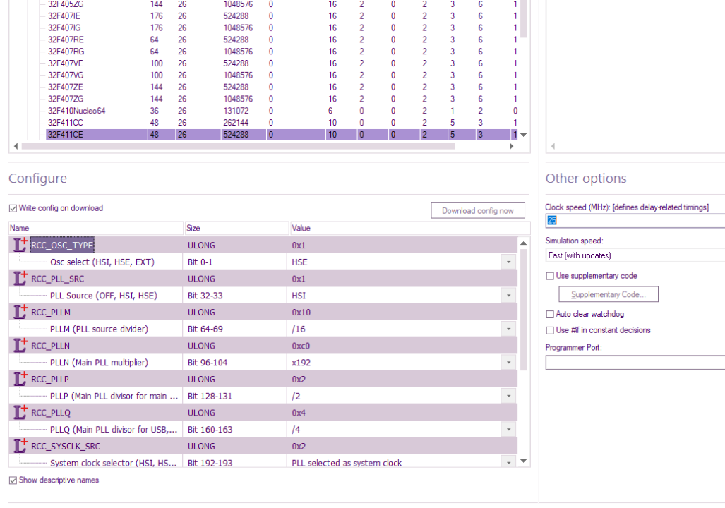

could it be that the problem is in the configurations?
the board has a main resonator at 25Mhz and for RTC at 32.768Khz

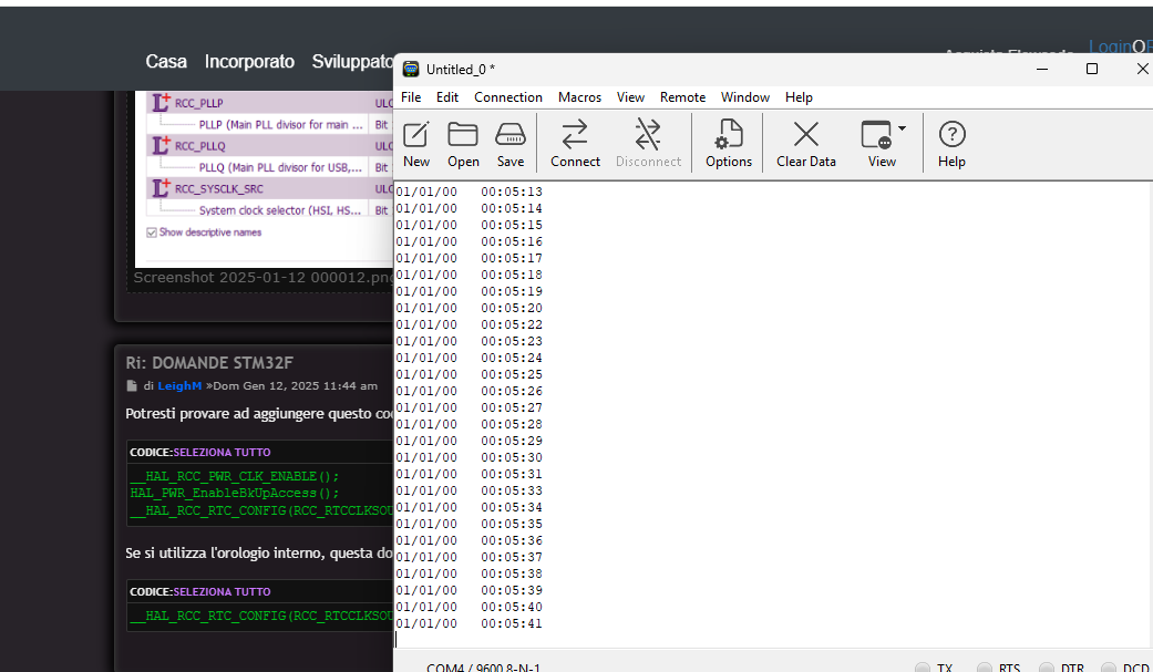

Post by max.tisc »
thanks to LeighM
configured with LSI it works, if configured with LSE it continues to block the program
