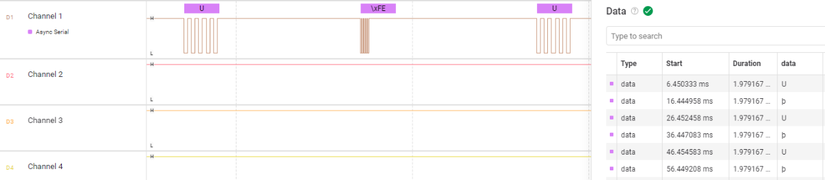

Just tested on the Uno and ChangeHWBaud is working as intended, toggling between 4800 and 19200 .
Analyser set for 2400 & sending U:
Do have an example .fcfx project where it is not working?
