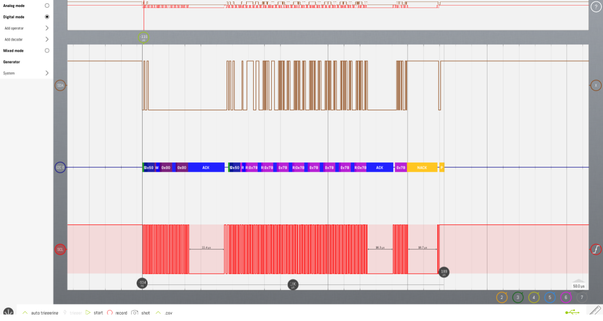

I did the test with an STM32F469 board. The STM32 does not have a break or only 1.3uSec
Just need 87uSec
STM32 read 6 Byte I2C Bus:
ESP32 read I2C speed increase

Had a little play using i2c_master.h and i2c_master_transmit_receive. This gives a bit of a boost to the speed - with a 22.4uS delay after sending the read address (again I am using an i2c eeprom, so this is 2 bytes). Then reading 9 bytes - there are two 'odd' delays at the last byte / final NACK.
It's a bit quicker - and I can 'push' the clock speed. The memory I am using works at 1.2MHz (but fails at 2MHz (and it was late so I only tried a few speeds) - the gyro might allow faster speeds - set in the first code block)
Time 190uS at 1.2MHz (209uS at 1Mhz)

- LabNation_Screenshot8.png (205.97 KiB) Viewed 2328 times
