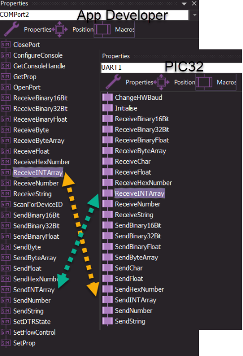

Posts: 1261
Has thanked: 234 times
Been thanked: 252 times
Re: Serial port communication
Hi Martin
Maybe this hint helps a little.
It's sending /receive a buffer in one go. It's possible to send a buffer with byte or integer .
Should work with the app developer and Arduino
I hope Ben makes these different buffers for the ESP32 bluetooth too.
That would be one of the fastest and easiest connections.
https://flowcode.co.uk/forums/viewtopic.php?f=4&t=186
