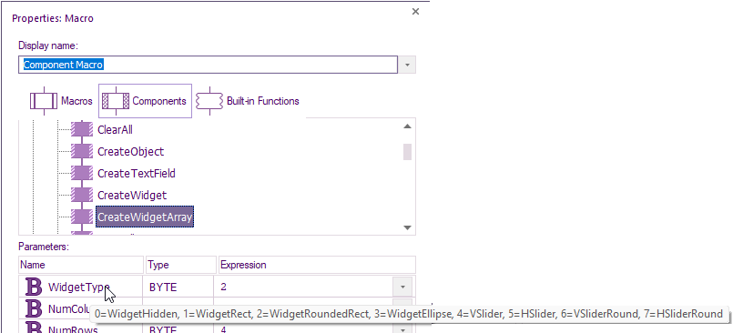

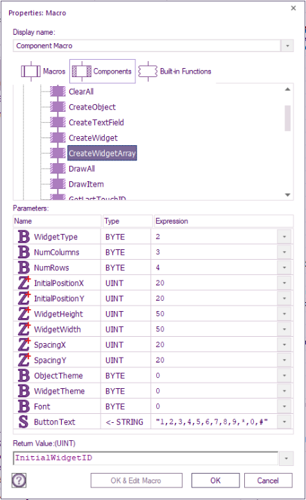

This is the function macro that is very flexible in what you can create:
Lots of flexibility and there are also tooltips to help.
Make sure you download the latest component updates, then reload project before running and sending to hardware.

Hi Martin!
First I try to simulate, get the error init, and if I try to compile I also get error, the init is there?
Br Jorgen
Br Jorgen

Hi Jorgen have you updated your components database so you have the latest Graphical LCD Manager?
Also Strings are being worked on.
As soon as they are completed, I will let you know.
Have you you tried the file from here?
