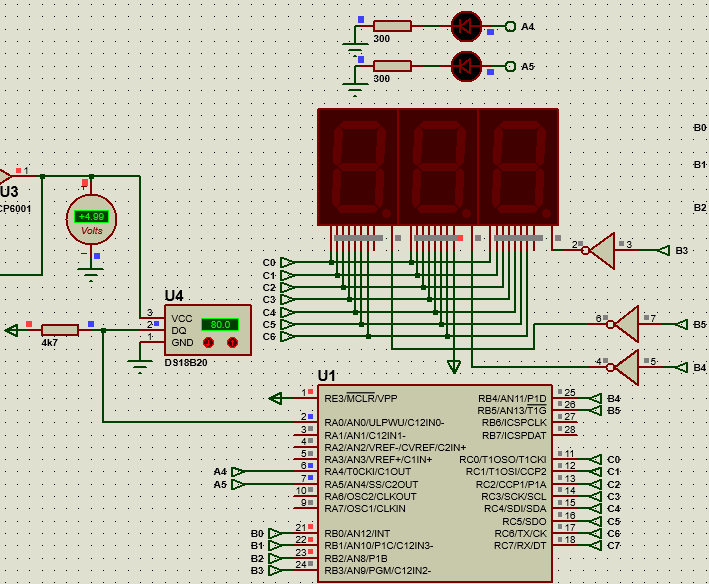

I have the attached file to display the temperature value of a DS18B20 on 7-segment displays.
In simulation it can be seen that the reading works but in physical form nothing is seen on the display.
The multiplexing routine is working well in other projects I have, but I don't know why it doesn't work here.
What I observe is that the control lines of the displays B3, 4 and 5 remain at high impedance (not connected to anything) and the same thing happens with the lines of the segments of the displays that are connected to C0 to C6
what could be happening?

If I disable all the blocks of the DS18B20 temperature sensor and set a fixed temperature, the multiplexing and value display section works perfectly.
But when I enable the sensor blocks the display stops working.
The effect can be seen in the attached file
C

Re: Mal ffuncionamineto del sensor DS18B20 y display de 7 segmentos
Trying to limit the error, I have been activating the sensor blocks one by one and I observed that the problem occurs when the following blocks are enabled:
SampleAdressedDevice
and
GetTemperature
It can be seen in the attached file
and
GetTemperature
Limiting the error further, I have changed the block:
SampleDirectedDevice
by
SampleAllDevice
And the display shows the fixed temperature.
But when the GetTemperature block is enabled, the displays stop working and all the pins that control them and those of the segments remain open or high impedance.
C.
by
SampleAllDevice
C.

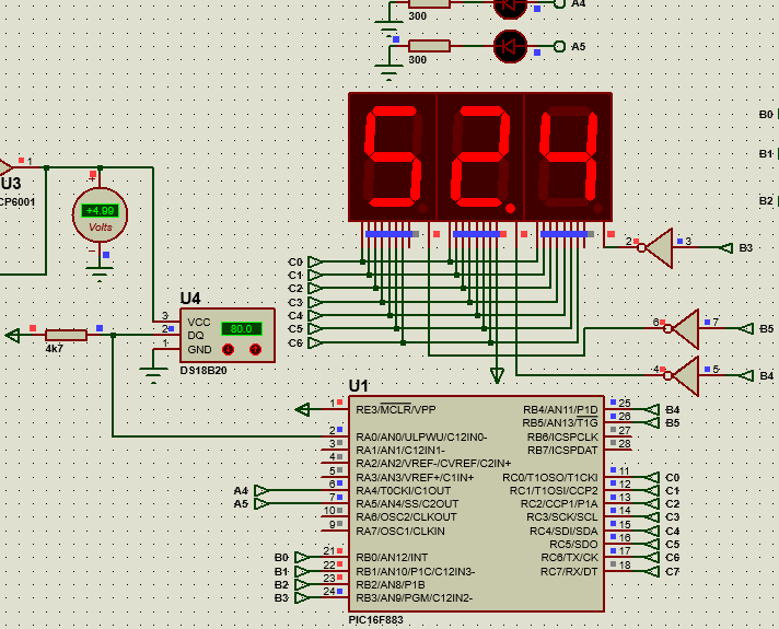

I attach 2 screenshots where you can see, in addition to how the pic and display connections are, in one of them, the error when enabling the "GetTemperature" block of the sensor.
As can be seen, the displays remain off and the lines that control the displays and segments are seen without any reference voltage.
In the other screenshot, with the block disabled, the displays continuously show the temperature value that I have fixed to test.
I have also tested that if more blocks such as decision or calculation are added, the effect becomes more visible since in addition to having to disable the "Gettemperature" block, other sensor configuration blocks must be disabled. The more blocks you add, the more blocks you have to disable.
Maybe it could be a question of timing within the sensor blocks?
C.
C.
