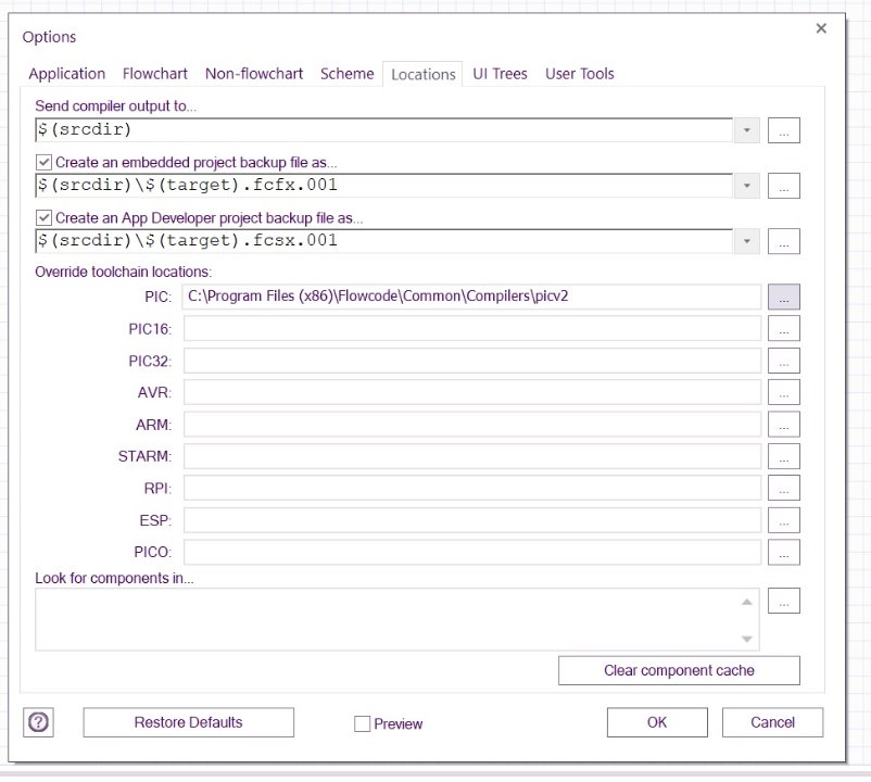

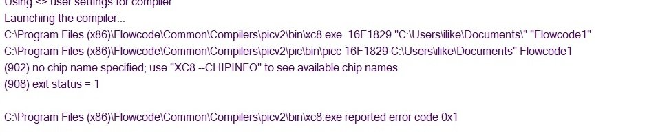

I have upgraded from Flowcode 8 to Flowcode 10 and installed the tool chain from the Flowcode website (picv2) to compile for Microchip pic 8-bit devices. When I try to compile to hex the compiler (XC8) gives an error message "(902) no chip name specified; use "XC8 - CHIPINFO" to see available chip names". It seems as though the compiler is not being passed or is unable to recognise the $(chip) parameter? Is there a missing file? Is there a problem with XC8?

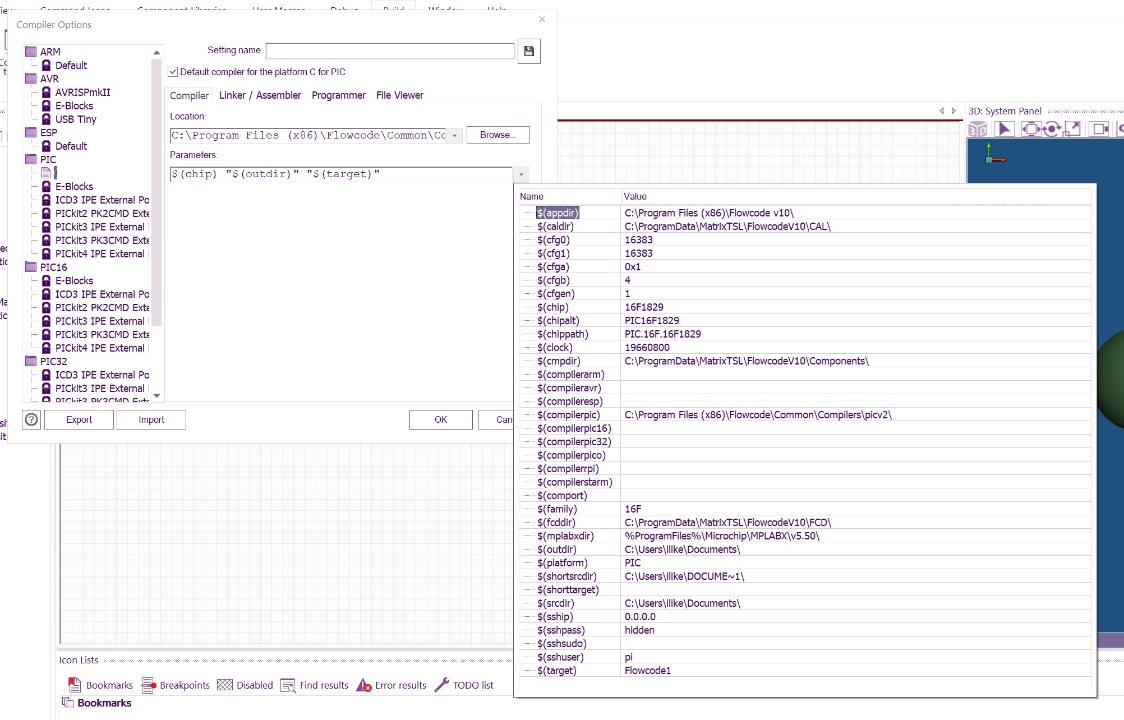

I have tried uninstalling/reinstalling Flowcode and the tool chain, installing the latest version of XC8 (V3.00) and followed the Wiki on how to change the Global Options Location to point to the newer version. In the Compiler Options I have tried variations on the $(chip) Parameter; forcing uppercase, lowercase and adding $(chipalt) parameter.
XC8 compiler error.jpg (36.09 KiB) Viewed 3183 times
Global Options Locations.jpg (68.57 KiB) Viewed 3183 times
Compiler options.jpg (126.77 KiB) Viewed 3183 times

I have recently found that XC8 v3.00 does not work with Flowcode ,that could be the cause of the errors?
I'm currently using v2.50
What you can try is Select Build > Compiler Options
For PIC select Eblocks, then Click on the box for Default compiler for the platform C for PIC.
That should allow you to compile to hex or if you you have PIC upstream board you can select Compile to Target.
If you want to use a later compiler version that the default, the easiest way shown on this post.

Thanks medelec35, I changed back to the compiler downloaded from the Flowcode website (in C:\Program Files (x86)\Flowcode\Common\Compilers\picv2) then selected the PICKIT3 (my programmer) in the Compiler Options and this allowed the C file to be compiled without warnings to the hex file.
