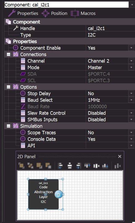

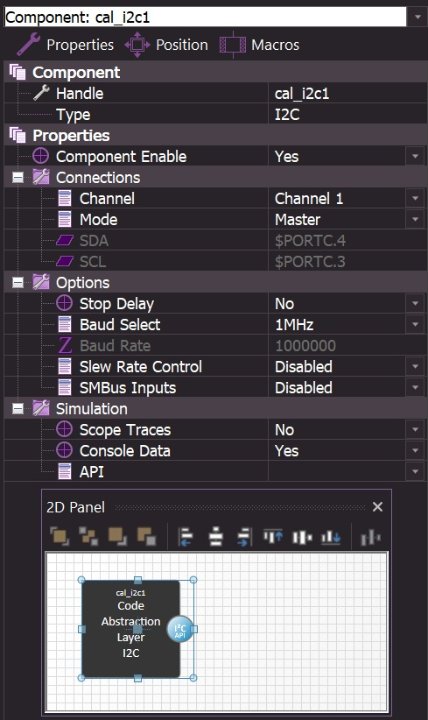

Hello!
I want to use the CAL_I2C component macro with a PIC24FJ256GA702 microcontroller.
In the Properties window, the SCA and SCL pins point to non-existent port.
If I change the I2C channel, the SCA and SCL port pins do not change.
Regards,
Sasi

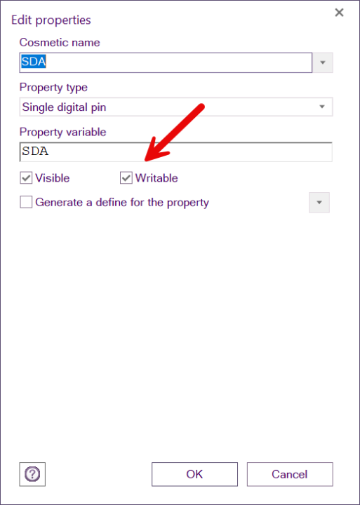

As a temporary fix:
If you double-click on the property name (e.g. SDA) you should get an 'Edit property' dialog box.
Click on 'writable' and then okay - and the property is now changeable...
