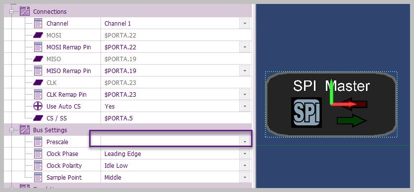

Hi Ben/leigh.
I have an issue with the SPI on the ESP32 Lolin Board.

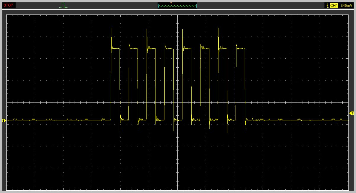

If there is no Prescale selected then the SPI is clocking and MOSI /MISO Is working ,If I select the Prescale anything below 10MHZ then there is no SPI
so from 8MHZ up 80MHZ seems to work and even no value for Prescale :D

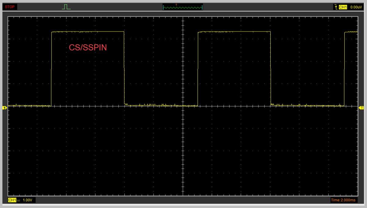

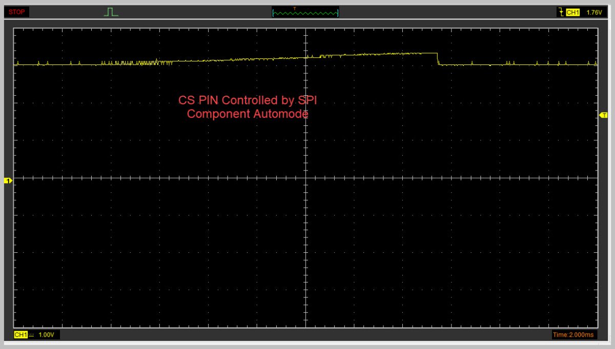

secondly the CS/SS Pins does not work automatically it just makes a funny shape on the signal it is trying to do something .
If I use the SPI CS Enable and disable macro's the I can drive the High and low .
I need 4MHZ Clock for my ADC device to work correctly :D
CS Pin Controlled by Automode Property
CS Pin Controled from a macro

Can you please try this on your ESP32 board.
Auto CS does not work for me and also I noticed that 6MHZ clock working (Did not measure the time I will do to make sure it is really 6 and not 8 Mhz)
If I use Enable_CS and Disable_CS the CS pin as defined in the properties function, it is when I relay on Auto CS that there is no CS signal

Despite the word "auto" I don't think that the SPI component does anything with the pin other than via the Enable_CS and Disable_CS

The auto property I beleive gets rid of the CS pin property when set to no, forcing the user to control the CS pin themselves or not use a CS pin say if the pin not available or permanently tied to ground.
"Auto" is probably the wrong label, it should be more along the lines of "CS pin controlled by the component macros enable/disable".

You either need the Auto property set to yes and to call the enable / disable macros or you set to no if there is no CS pin.
