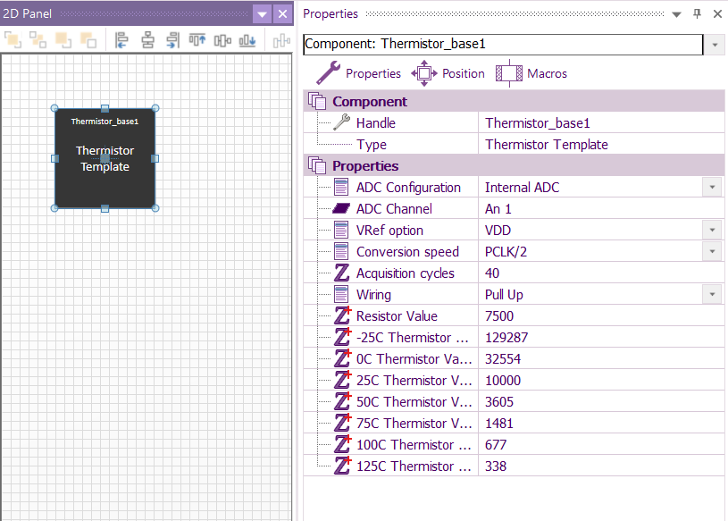

I've been using the thermistor component in my projects for a long time, and it's always worked well for me.
I recently noticed that new builds of old functional codes are showing errors in the thermistor readings, even if I haven't modified them.
I remember updating the FlowCode libraries. I don't know if that might have been the reason.
I'd like someone to test the thermistor component to see if the temperature readings work correctly. The readings I'm getting now are incorrect and out of line with the actual values.
I'm uploading some simple test code I created to test the readings.
The NTC is in pull-up mode, and the additional resistor is 7.5kΩ.

Have you tried using a fixed resistor of the same value (10K) in place of the the thermistor, then getting the adc and temperature values?
If you can do that and let me know the results.
What is the value of VDD?

VDD is 3.3V.
I used a potentiometer to test: using approximately 9.2kΩ, the temperature is 25°C.
Reducing the resistance slightly (simulating a temperature increase on the NTC thermistor), the temperature reading immediately jumps to approximately 44°C. This is happening in several codes using the thermistor component.
It didn't happen before.
There is this discontinuity point at approximately 9.2kΩ.

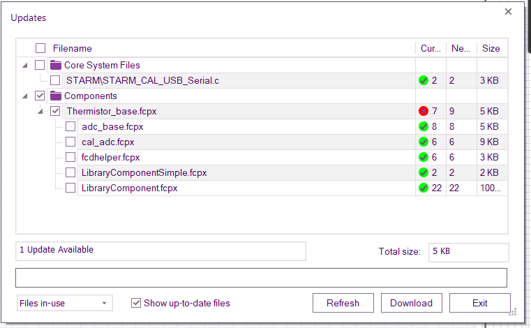

If you want to confirm if it was an update or not that caused the issue, take a look on how to rollback a component version

I followed these steps. I used the previous version of the thermistor. Now it's working again.
I didn't know about this tip. It really helped me a lot.
I'm very grateful for your help. I'm very satisfied. Thank you very much!
