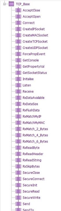

My poor little brain cell is really getting fried, I looked at the help for the TCP_IP_Pi component and it did not have a lot of functions. I downloaded the example and was really stunned as it had all the same functions as the W5500. The only issue is that this has TCP_Base in the project explorer. Where is this component as I cannot find it anywhere.

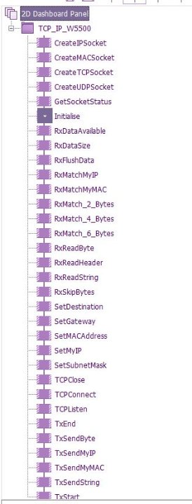

This is some of the functions for the W5500
This is what the TCP_IP_Pi has
I cannot add any more files / screenshots so need to continue with another post

And this is what is in this example for the TCP_IP_Pi file
FC_Comp_Source_TCPIP_RPI.fcfx
(32.39 KiB) Downloaded 189 times
From what I can see this has all the functions to W5500 has, I could not find this component anywhere.

I looked at the help for TCP_Base and it appears that is for simulation only no no use anyway.

I think you are right, the thing I need to figure out is how to use the Pi functions to do the same or I will need a total rewrite which is probably beyond me.
For example, W5500 has CreateMACSocket, CreateTCPSocket & CreateUDPSocket. The TCP_Pi only has SocketOpen and parameters for either UDP or TCP. Nothing for MAC so that does not seem possible.
Then there is SendMyIP & SendMyMAC, I an not sure if I can get away with Send and then the 4 bytes.
