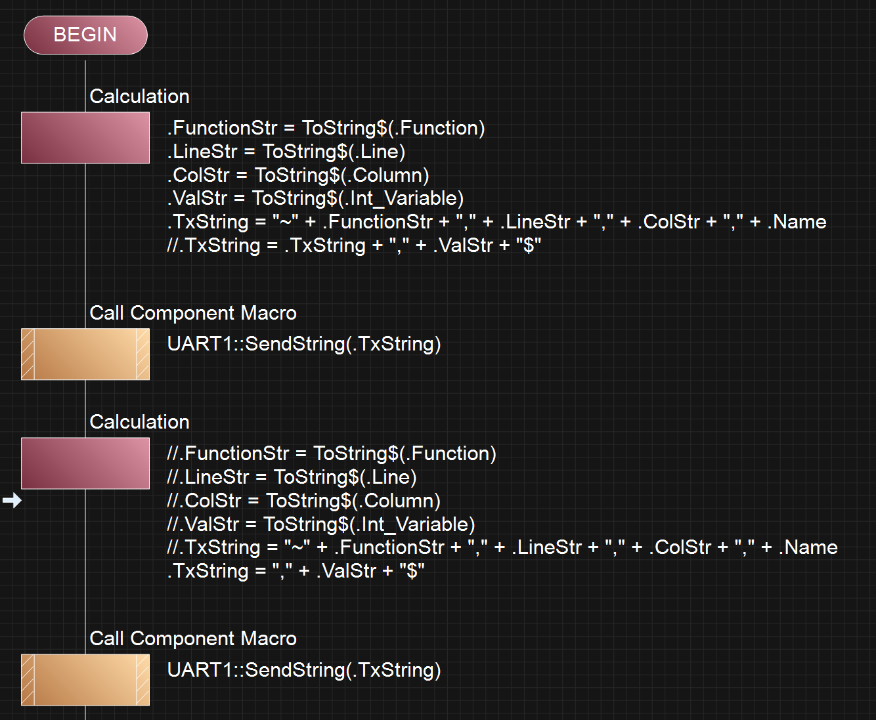

Attached is a simple bit of FC used for testing another program. It builds a string and sends this out over the UART at 57Kbit.
A assembled string can be over 20 characters
FC is attached.

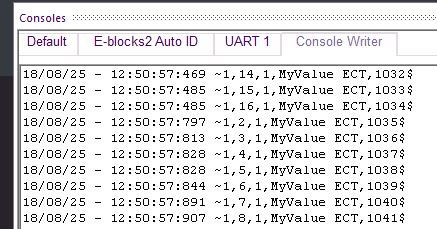

In simulation the output stream is fine, both UART Console and the assembled string shown on a console Writer are fine, with strings over 20 Characters
hardware is PIC18F2585 and the output string is always tuncated to 20 charaters. I dont think it is a hardware limitation.
~1,9,1,MyValue ECT,2$
~1,10,1,MyValue ECT,$
~1,11,1,MyValue ECT,$
I'm fairly sure the error is somewhere in the string concatenation, as the last value (my terminating character $) is always correctly added.
But the value (just before the terminating character) is being truncated to a length that always results in of 20 char max.
I've checked my FC variable to ensure everything is sized to handle a string larger than this, but the problem persists.
Any Thoughts? J.

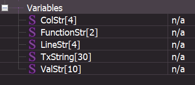

It does not appear to make any difference what length I make the resultant's String length. i.e. TXstring[25]
I dont know the details of how strings are concatenated TBH, But I presumed that if an actaul string was 4 characters but the string containing variable was declared as 10 characters, that is just a limit on the size reserved in memory.
I have tried various sized strings for the resultant, including 30...no improvment.

Sorry, my help was wrong. I didn't notice a line.
I think you're doing everything right. Maybe you can split it into two strings as a test.

I forced the "UART Send String" macro to send -- .TxString = "~1,1,1,My Value ECTBB,12345$" which is more than 20 Char
This is sent fine, so its not a hardware or UART buffer issue.
Looks like a concatenation issue with strings over 20 char.
I cant find a working concatentaion method yet, So I'll be interested if the FC team know of a good workaround or known issue.
In the mean time, I'm splitting the String into Two, and just sending them one, after the other. Bit clunky but seems to work.
Thanks, J.
