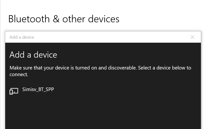

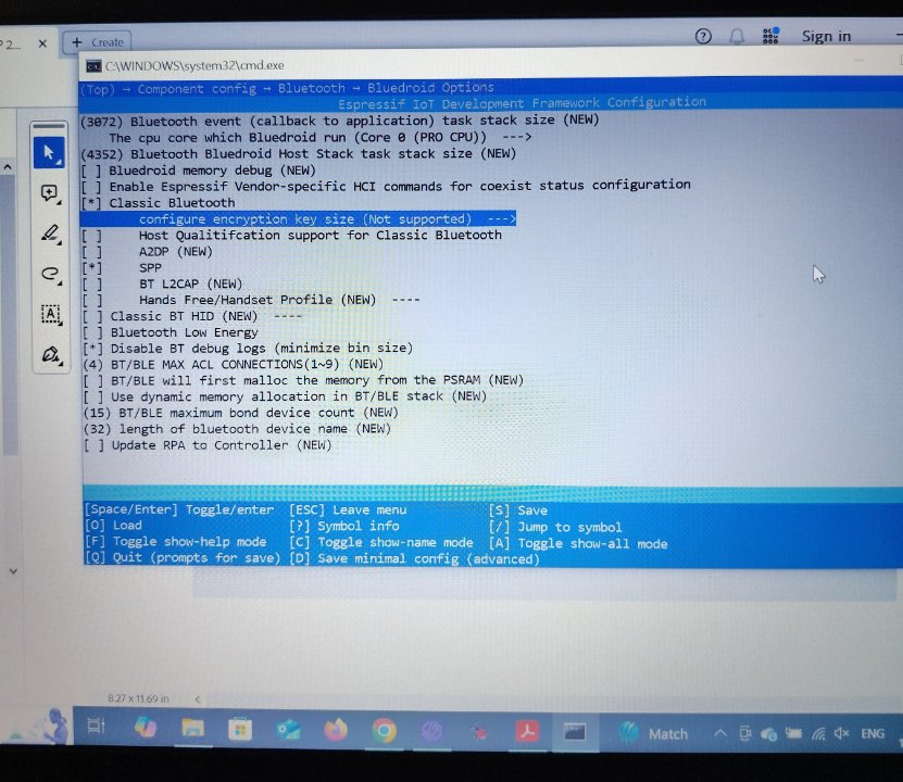

hi
I'm trying to use Bluetooth with esp32_wroom_32 module and refuses to compile .
Any help is much appreciated .
Thank you

Since Ben stated that, there has been a change.
If you installed the Flowcode ESP32 tool chain
menuconfig.bat
is now within the
C:\FC_ESP\(esp type used)
E.g
C:\FC_ESP\mtxesp32s_sdkconfig
C:\FC_ESP\mtxlolin32_lite_sdkconfig
etc.
I have not played around with Bluetooth yet on the ESP32,
but I know other forum member have so it's well worth reading their findings.

I managed to find "mtx" folders ,in "FC_ESP" folder in C directory . Most of them are empty except "mtxesp32s_sdkconfig" and "mtxesp32_s3_sdkconfig" .
File "menuconfig.bat" from "mtxesp32_s3_sdkconfig" I was able to open without problems and I was able to attempt a test of ESP32S3 , unfortunately unable to compile due to errors .
After many many many attempts I managed to open "menuconfig.bat" from "mtxesp32s_sdkconfig" . It is a little different from Stefan post and has no setup for a password . It compiles ok , can connect with my phone and can receive data from my phone .
Now I need to find out how to set a passkey and set the module as slave and master .
