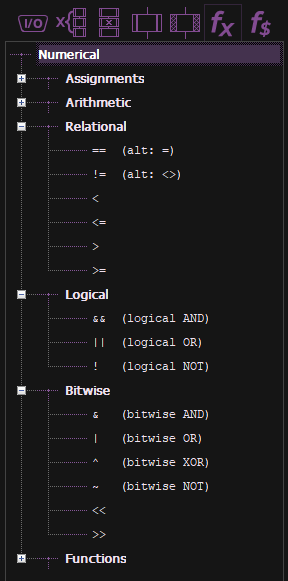

Here's a screenshot of the new dropdown for mathematical functions, which groups together similar mathematical operators:
flowcode operators.png (22.92 KiB) Viewed 5175 times
Note also there is a similar issue with "equals". In C code, the single "=" is used when assigning values to variables and the double equals "==" is a 'relational' operator that is used when comparing values (e.g. "is x equal to 5"). Flowcode has always allowed the single "=" to mean "is equal to" in a decision even though this is incorrect in most modern computer languages (we originally copied this dual use from BASIC). Recent versions of Flowcode have also allowed the double "==" when comparing values (as per C, JavaScript, etc).
We continue to allow this dual use for the single "=", but now the suggested relational operator when comparing values is "==" as this makes it easier for Flowcode users to understand and learn C code.
