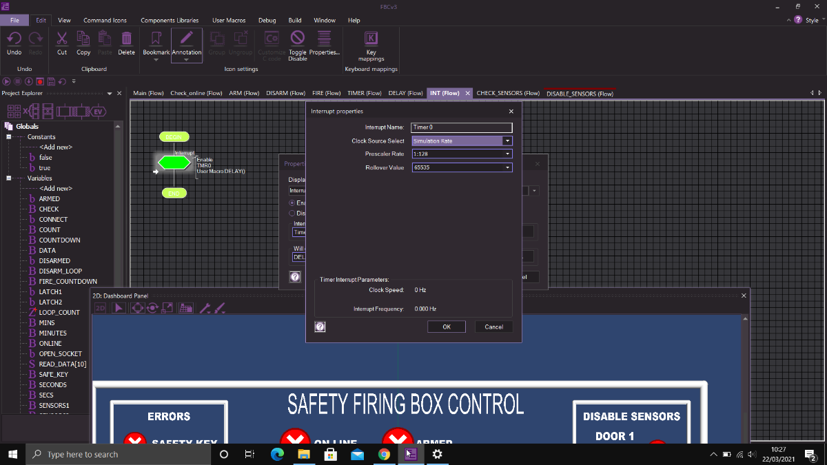

Since i had the problem of not being able to open the project i now have a problem that the interrupt does not have a clock frequency.
How can i fix this i have tried the following.
1. delete the interrupt icon and replace.
2. unistall flowcode v9 and reistall.
but still not working.

Thanks for the file fix but still have problem with the interrupt having no clock frequency.

Yes 1 second is what i want. before it went all wrong it have a clock frequence that the interrupt worked from but have a frequency of 0hz now.

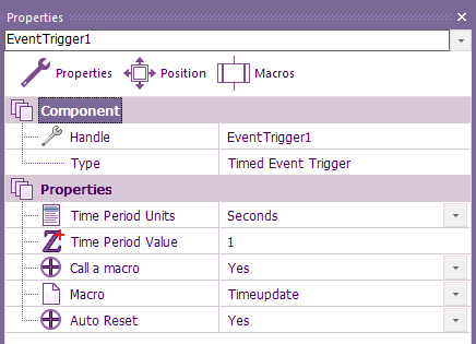

In that case you don't really want to use the interrupt.
Use the Timed Event Trigger instead.
I was really amazed at the accuracy!
Much better than interrupt.
I Ran it and compared with a stopwatch.
It was still spot on to the second an hour later.
It's easy to set up for 1 second intervals:

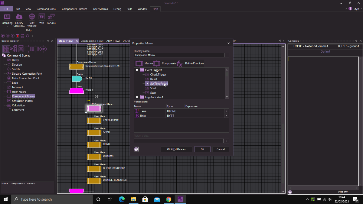

I do not see what you have on your event timer.
what am i doing wrong? Thanks,
Wayne M
Wayne M

What I have posted is within the component properties.
right-click the component on the panel & select properties.
That is how you set up the time the event triggers in.
You don't require Period of the component, only start is required.

Hi Martin,
Controller PIC12F683. All settings went over but does not work!
