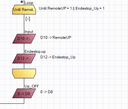

I have tryed to make a program where I have a 2ch remote, one for up and one for down. I want to when I press the Up button the port start opening and stop at the end by a endswitch, but if I want to stop on the middle on the way up I press the Up button again but the remotebutton does not work the endswitch work in real world, all work in simulation.
I use in the loop : RemoteUP = 1 || Endestop_Up = 1 (Also tested with OR) the endstop wok fine, but not the Up botton. hope it make sense.

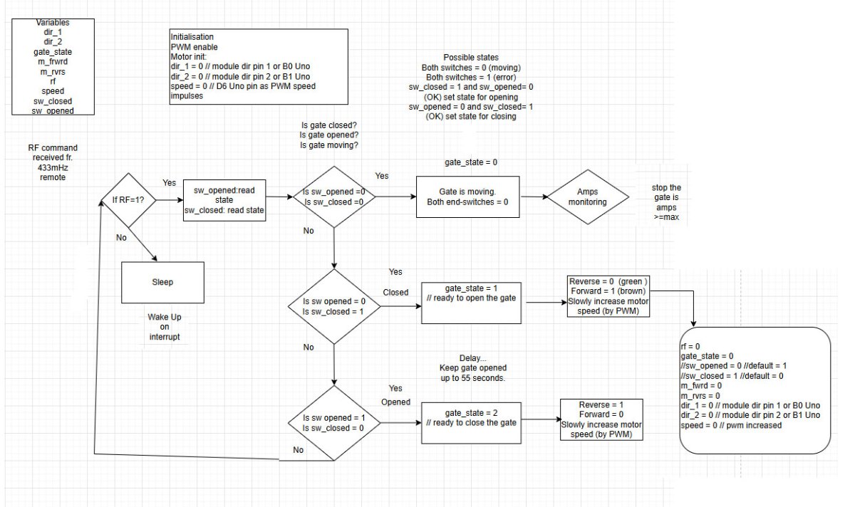

In the gate (door,etc) I used 4 states.
0. Gate is moving
1. Gate is closed
2. Gate is opened.
3. Errors
Note: this is an old draft block-diagram.
Moving state is a complex one. Plenty of possible errors.
In case of an error, stop the gate and id the error.

I just can't understand why my OR function doesn't work when I wait in a loop, and it annoys me (see picture)
Maybe I am wrong but, is it correct that, that, stayin the loop until RemoteUP = 1 || Endestop_Up = 1 if one of these getting high leave the loop?
Only Endstop work. It work fine in simulation

Re: Loop While!
Hi Jorgen,
I'd recommend some parenthesis around the parts of the OR
So if (A = 1) || (B = 1)....
Alternatively - as A and B are 0 or 1 (RemoteUp and EndStop!) - declare them as boolean (true = 1 and false = 0)
and then just if A || B ... (Use || for OR and && for AND - though bitwise OR should work for 0 and 1)

Hi both. Thanks again.
I think I've tried all the tests.
I tryed all these:
UNTIL(RemoteDown == 1 || Endestop_Down == 1)
UNTIL(RemoteDown = 1 OR Endestop_Down = 1)
WHILE(RemoteDown == 0 && Endestop_Down == 0)
UNTIL((RemoteDown == 0) && (Endestop_Down == 0))
And your suggest Martin (RemoteDown == 1) || (Endestop_Down == 1)
none of them work
I sense that one of the variables is not being read in FC as soon as there are two variables, bugs?

A dirty way to make as many interrupt input I wish by help of timer and to awoid the OR function in a loop, it work perfectly, if you wish I can add some comment in the program for better understanding?
Maybe the MM team will look into OR funktion and check if I am rigth or not, until then I will use the new control I have made.
