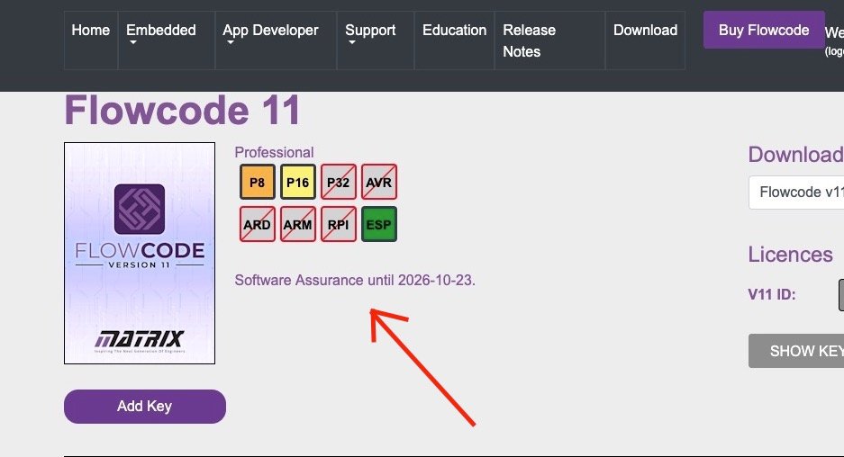

Hi Steve,
Thank you, I have got my Flowcode V11 license.
Under Flowcode V11 License it is mentioned as "Software Assurance Until 2026-10-23"
kindly help me understand what it means to my license.
-S_V

Thanks for the question.
Just like previous versions of Flowcode, when you purchase Flowcode you receive a perpetual licence to use it forever. During a major release (e.g. v9 or v10) we provide free updates for the software which often includes new features, new components, bug fixes, etc. And when a new major version is released, you are charged to upgrade to the new version - often with a discount (e.g. 40% when coming from v10 -> v11).
Our new Software Assurance scheme formalises this process to some extent. When you purchase v11, you will receive 12 months of Software Assurance, which means that any updates (large and small) are free for you during this period. Towards the end of this 12 month period, you will have the option to extend this Software Assurance for a further 12 months.
