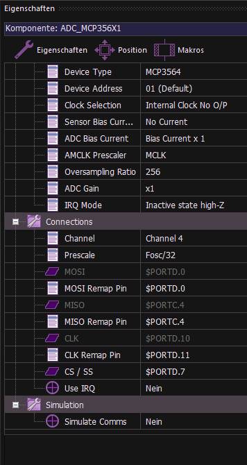

For the ADC3564 connections channel 4, I have MOSI on port D.0, MISO on port C.4, CLK on port D.10, and CS/SS on port D.7 in terms of hardware.
I cannot set the CLK remap pin to PortD.10. This makes it look as if two pins are being used. The following can be seen in the image clk. on the logic probe: image log, log2
Incorrect data is being read.

SCK is not remappable so the pin is fixed no matter what the remappable pin shows.
With Channel 4 selected, the fixed pin is D10 ,so your image for connections is correct.
You can confirm this via the datasheet or target device image within Flowcode.
With SPI the remappable functions are for SDI, SDO and SS
