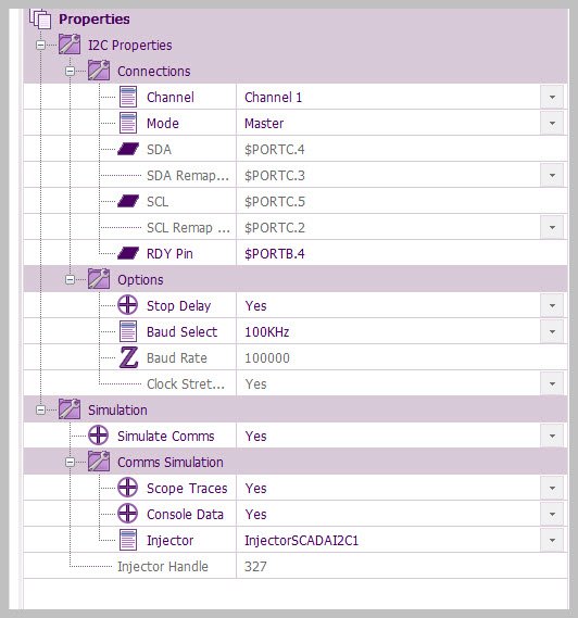

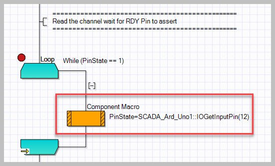

I just want to ask during the Comms Simulation is there another way to read a Pin which is defined in the properties of the I2C at the moment it seems it is only possible by using the SCADA macro IOGetInput() as below( I need this pin as the ADC asserts this pin when the conversion is completed and the data should be read,
In the real component(after) exposing it should read the RDY pin specified by the user as below
Or should I just use the IOGetInput() macro and as a last step replace that part with a read to the real pin in code only problem is if the user will do Comms simulation then the code will not work , may be you guys have better solution

That's a tricky one, reading the pin like your doing is certainly one way.
Is there a maximum time to be ready where you could just delay for that maximum time and then be sure that the sample is done and ready to collect? Might slow things down a bit but keeps the sim simple.

Hi Ben,
Thanks ,yes it has a sample time so at 860 SPS you need with the internal 1MHZ OSC 1.2mSec +/-10% so around 2mSEC I can delay it
for testing that is ok ,reading the PIN is slower might be slower but I am not testing for real time sampling so it more getting the function correctly for the component and in the real HW it can read the PIN ,
This is working on the SCADA reading the pin as I do .
just was thinking if there is other possibilities..
Thanks again
