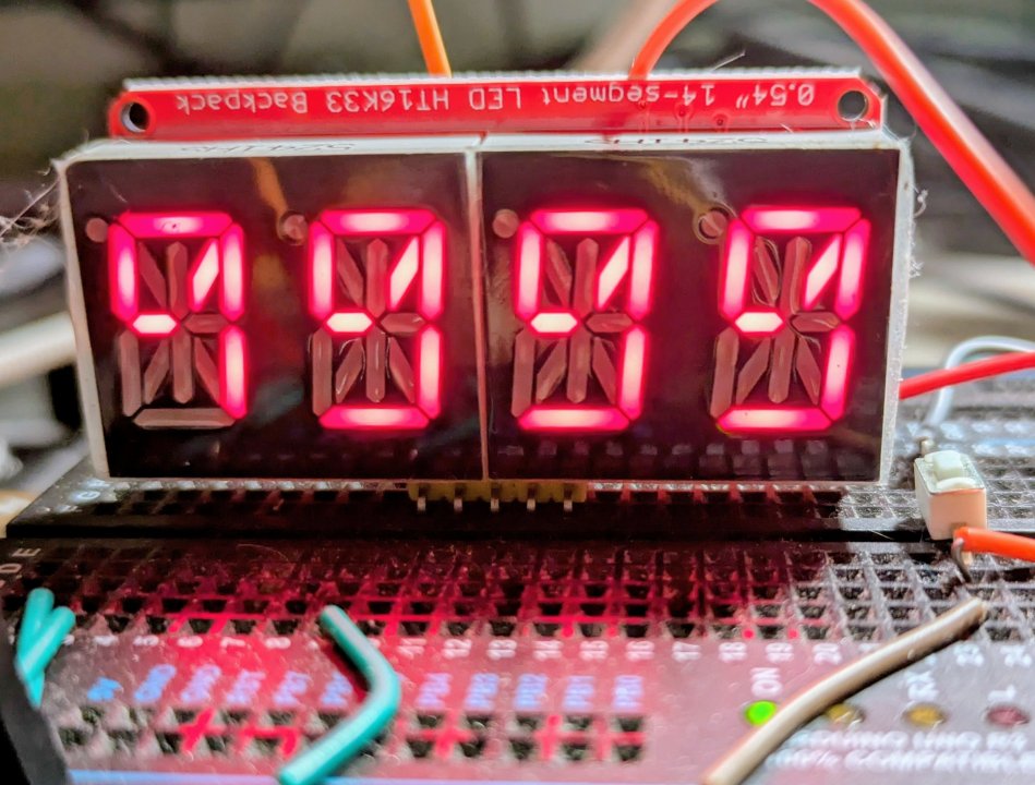

The HT16K33 arrived first (AliExpress) - and it has 4 x 14 segment digits attached.
I'm hoping others will contribute - or at least play along. My first step (always) - is a very basic program - to check that I can actually 'talk' to the hardware - no point in writing reams of code - to find that nothing is displayed!

Note that the display is just 'plugged' into the Arduino - and is upside down - dp at top left! I just photographed a 'random moment' - and digit 4 is yet to change to reflect the others (probably should have added a delay!) The digits look rather brighter - and the off segments are far less noticeable to the eye...
