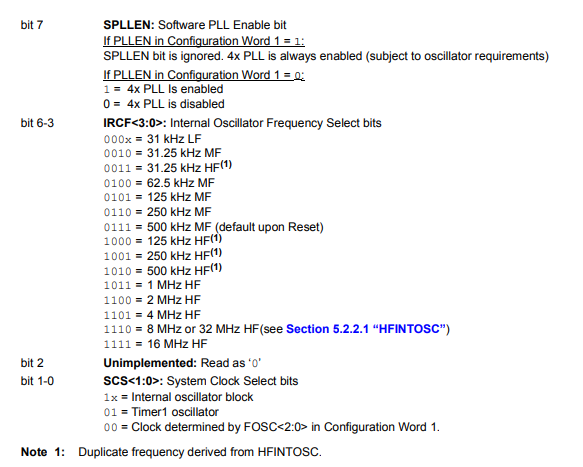

Hi Bob The first thing you do is make sure your hardware is setup to rub at the correct clock speed.
Always flash a LED for 1 sec or use a logic analyser or scope
Within projet options you have set the clock at a frequency which does not exist - 10MHz.
The would cause issues with your PWM.
The only internal speeds available are: if using PLL, don't forget to enable it within configurator settings, or set SPELLEN to 1
What I do with 12F1840 is set clock speed to 32 MHz and use a C code block at the start with
OSCCON = 0xF0;Martin

That is correct.siliconchip wrote: ↑Sat Jan 03, 2026 5:31 pmi set the chip at 10Mhz from the config page so im guessing it doesnt slways mean a chip can run at that frequency ?.
You have two options.
1. use the internal osccon component.
On the components ribbon use the magnifying glass and search for intosc
Or use the values within the image I posted as they are the only internal oscillator values that can be use.
Its the OSCCON = 0xF0; that sets the hardware speed.
It's the configuration setting that sets the delays e.g. for UART, PWM, delays etc.
So it's vital that they both match!
You set OSCCON to 0x58 = 0b01011000.
Ignoring bit 7 as that is SPLLEN, leaves you with 1011 as 4 bits are used to set internal osc frequency.#
If you look at the image within my first post 1011 = 1MHz, yet you have set clock within configuration settings to 10MHz.
That is a mismatch by a factor of 10, which is why PWM is not working as expected.
After you make adjustments and match clock speed to internal osc speed, the PWM can then be investigated if still an issue.

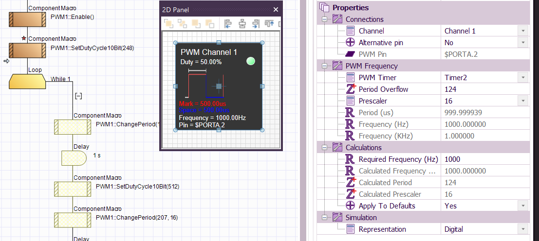

thanks for the replys, i can confirm that the config allows me to flash a led at 1 second intervals, ive now used this congfig but still not getting any where i was under the impression if i added a component macro and set frequency then the duty cycle would be 50% automatically but its not, i can alter the peiod and prescaler and get the frequency i like but duty cycle is still not right, ive tried with PLL enable but made no difference, ive also tried with the 10 bit duty cycle set at 512 for 50% but again not right,
cheers bob
cheers bob

Re: PWM ADVICE PLEASE
If you are correctly getting 1second then internal osc and clock settings match.
Does the simulation match the hardware?
With PWM the Period Overflow value represents 100%.
For 8bit, 100% PWM Duty = Period Overflow.
For 10bit, 100% PWM Duty = Period Overflow * 4
124 * 4 = 496.
50% = 496 * 50 / 100 = 248
Try a duty of 248 and check both simulation and embedded both show a PWM with a duty cycle of 50%.
Start at the basics, let the PWM component do all the calculations.
Change Appy To Defaults from No to Yes, then have just 1 * SetDutyCycle10bit to 248.
If that does not work I will check with my hardware.
512 is wrong, which is your main issue.
I'm assuming you just thought because you are using 10bit PWM then 50% of 1023
You only need to pay attention to Period Overflow as explained in my previous post.
If you look at the image below: You can see the Period Overflow is 124.
In the calculations I showed you that for 50% duty you need to use the value of 248:
A bit more maths.
If you are using 512 then using transposition, actual PWM is 512*100/(124*4) = 103.2%
That is why you get unexpected results.
