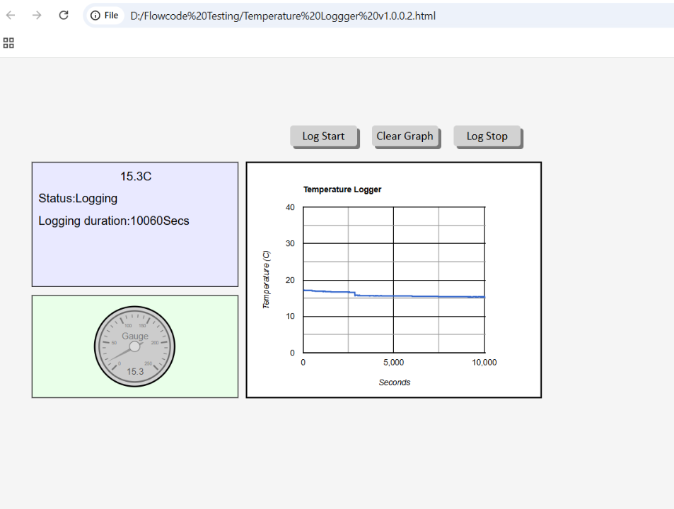

I have recently developed a web app that has a line chart and updates the data every 10 seconds.
The web developer can log.
Data Logging2.png (82.67 KiB) Viewed 6259 times
I used a TTGO ESP32 which connects to my WiFi.
Connected to the ESP32 is a DS18B20 used for sending the temperature data.
It not only displays the temperature on the gLCD, it also sends the data to the web app via HTTP when requested by the HTML webpage.
I'm not using PC developer at all for this project.

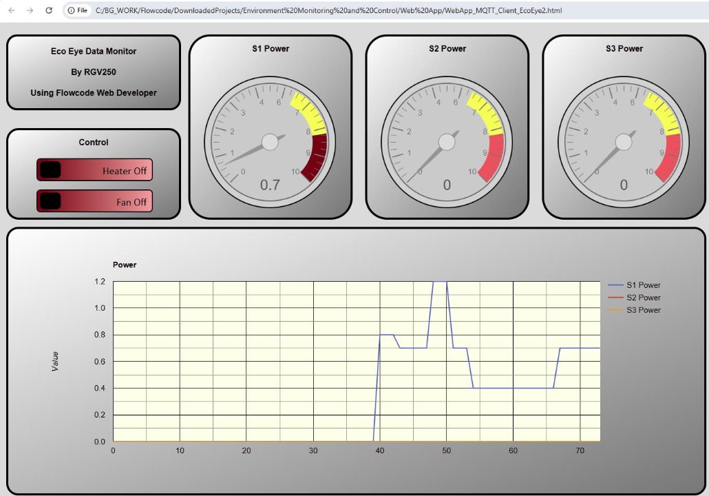

What a weekend, I decided it would be easier to migrate the sensor code to the ESP as I knew that worked and I have never tried web developer on Raspberry Pi. In hindsight it might have been better the other way round. I am not a great lover of the ESP as there is no consistency for the pin outs and everything was a pain. I finally have the serial data coming in and I have a working web page. The other issue I have found out is the serial input seems to be tied to the USB port as I have to unplug the sensor every time I download to it.
The only thing I do not like is the chart as I would like to show the last x hours and where this updates every 4 seconds in a day it will be 0 - 21600 and not going to be very readable. I am not sure if the time can be shown for the X axis as that would be useful.
