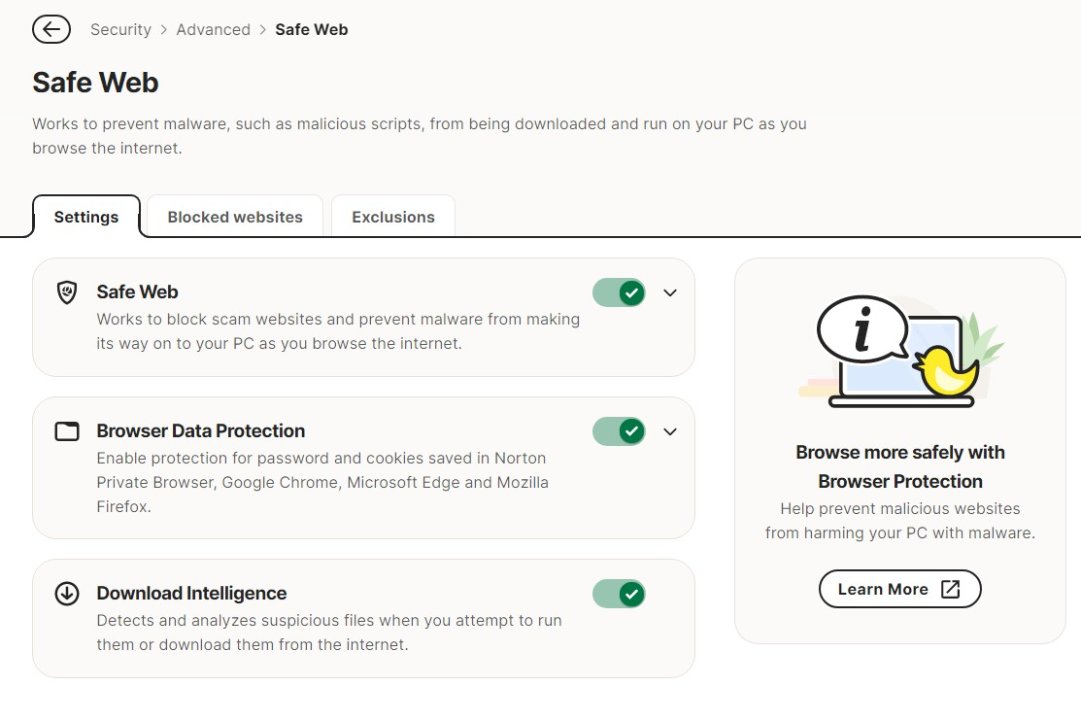

I haven't had any need, but you can whitelist from here
Screenshot 2026-01-16 095804.jpg (76.69 KiB) Viewed 4543 times
In exclusions you can specify a website you know to be safe and trust.

Thanks, I have it working of sorts, I am not sure why I needed to add to white list where temporary disabling Norton still blocked it?
