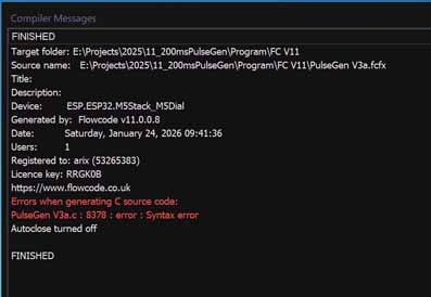

I hope someone can give a couple of pointers to help debug a Flowcode program I have written for the M5Stack Dial. The program simulates as intended but when compiling I get the Syntax error shown below.
Compiler error1.jpg (31.26 KiB) Viewed 7118 times
Apart from providing the line number (8378) no other information is given.
My question is how do I identify from the compiler message where the error lies within my flowchart?
The C code just after the reported error line relates to ‘gLCD Font2’. Font 2 was one of the standard fonts provided with FC V11. All that I have done is to call it up within component macros.
I have attached the program which is a pulse generator. When the program is Run in simulation the menu options are selected using a combination of the Quadrature encoder and the Bezel switch.
I am stuck at this point, so any help will be greatly appreciated.

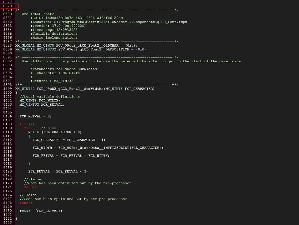

That is the area where I am getting stuck. I view the C code file, and in particluar the code around line 8378, but I cannot determine precisely to which component macro command icon it relates.
In the snipit of C code below it appears to relate to the use of Font2 by the gLCD component, which to me looks Ok. I am probably missing the obvious.

Having looked into the source of the error a bit further, it seems the gLCD_GC9A01A_SPI component was the cause. After replacing the component I was able to successfully compile to C. I suspect the display component might have become corrupted whilst I was working on the program.
However, I now have several errors when compiling to Hex and I am not sure how to interpret them. I have attached the Compiler Message file in case anyone has a spare moment to take a look.

Leigh and Martin,
I have implemented both your suggestions and now have my program working on the M5Stack Dial. :D
Thank you both so much for your help. It was very much appreciated and especially so knowing that you did it in your spare time.
KR
