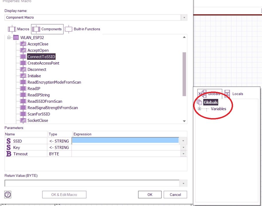

Global constant is not accessible inside the F11 WLAN_ESP32 ConnectToSSID component macro.

Re: Global constant is not accessible inside the F11 WLAN_ESP32 ConnectToSSID component macro.
I've also reported this - don't use global string constants here - connection will fail with the password as the two strings concatenated.
Using a string constant (Connect("SSID", "Password") or string variables is okay though..
The string length FCsz_VAR doesn't include the termination character (\0)
