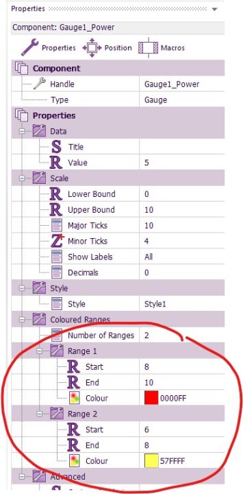

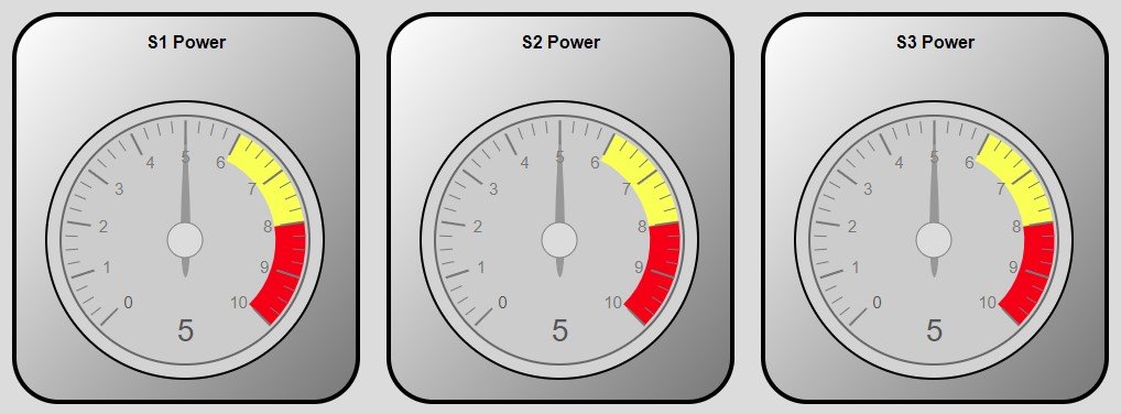

Not exactly a bug but a bit annoying, I set a couple of ranges from 6-8 and 8-10 but on the actual page they are shown from approx 6.4-8.2 and 9.2-10.
Gauge ranges.jpg (53.26 KiB) Viewed 4379 times
Gauge ranges 1.jpg (21.48 KiB) Viewed 4379 times

If you look at the gauge values, there's something else going on. There is no number "5" on the dial.
But I can see the issue. The "Major Ticks" is set to "10", but it needs to be set to "11" (the scale is from 0 to 10, which gives 11 major ticks).
