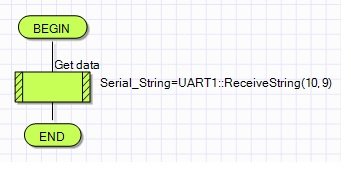

I setup an interrupt on serial-in data, and load string info into a variable called "serial_string"
That serial string gets all data as expected in simulation - but not working on my hardware.
I rearranged my program and now I poll with the same "serial_string" loading from (serial_string = Uart1::ReceiveString(10,15)
Working this outside of the interrupt gets my data.
You will probably request my program but I have rearranged everything now after spending 3 weeks of empirical changes trying to figure out why I can't get serial data using the interrupt.
I'm not sure how you can keep up with the multitudes of PIC chips and suspect that hardware has not been tested in every case. Could someone take a close look at this and let me know if the compiler is setting up the serial interrupt correctly?
I have attached my program which is polling.

Serial Handler is not the interrupt at this point. I have tried a single component in the interrupt to collect data understanding that we should be in and out of the routine. However, I could stay in that routine for a week if I disabled interrupts and re enabled them at the conclusion. Been there tried that too.
I'm pretty sure that the serial will not run. But I will be attempting to use the interrupt again for a last try.

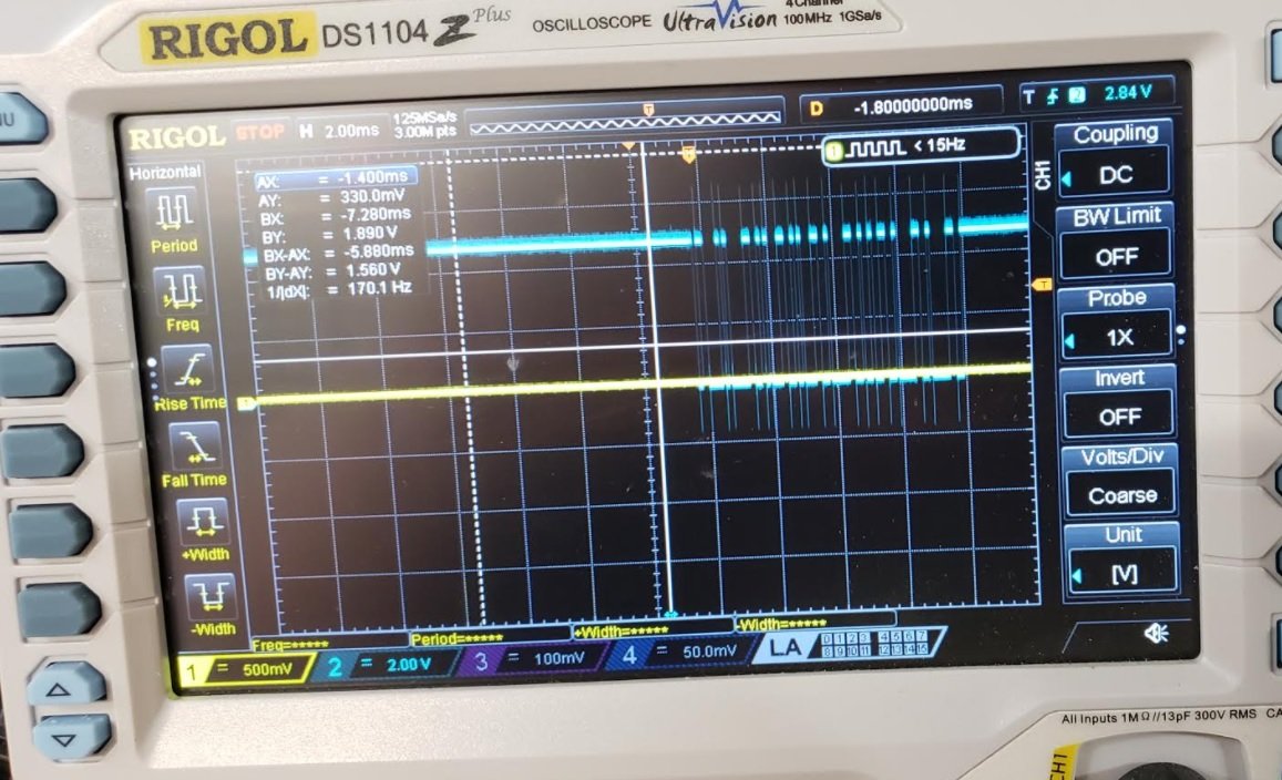

So I put the serial interrupt in, and still no info is going into the serial_string.
I put my scope on the serial input pin to the PIC24fj64GB200 with one channel on the data, and the other on the ACtive low pin for the driver.
Data is getting to the chip, and the interrupt is not working properly.
Thanks for your demo. I would speculate that the interrupt for this particular chip is not running properly.
Can someone verify this for me? The system works well with the simulator.

First we need to check if the interrupt is working,
for which I would suggest a very simple interrupt function where you call a single ReceiveChar() and toggle an output.
i.e. output low, ReceiveChar(), output high (aka flash a LED)
Check this occurs for each serial character with your oscilloscope.

Thanks Leigh.
Actually, I have put an xor for an LED in the interrupt routine. The LED is affected by this. So I believe that the interrupt is working.
SO I think we are down to using a string in the interrupt. I don't know where the circular buffer component is, and I'm not sure if I know how to use it either.
Thanks for the focus.
