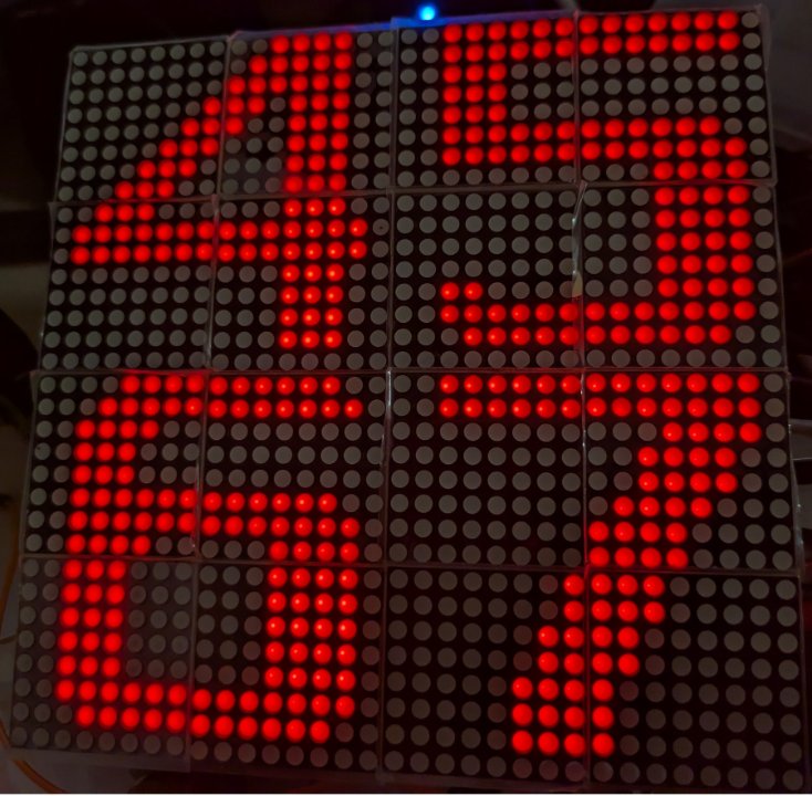

I tasked gemini with creating a character set for the digits 0..9 and the results were 'poor' - after several iterations, I decided I needed simulation - to make visualising Gemini's efforts quicker.
I eventually tried ChatGPT - and the results were slightly better - though if you try this, I think there is still room for improvement (the 1 is a bit 'thin' and 0 is a bit 'boxy') - if anyone has any artistic skills - there are 16 x 16 pixels per digit to play with :-) (I have no artistic skills - but I think I could have done as well as gemini with a pencil and graph paper - the 6 and 9 caused it a lot of difficulty)

ChatGPT's effort isn't bad for most digits - I haven't removed the protective film either!
