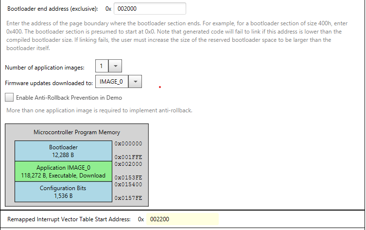

Thank you very much for your reply. I suspect that the problem is that the IVT code is not being written into the relocated area. I am using the Bootloader library in MPLAB, which states that the IVT is automatically relocated to address 0x2200.
When I program an application using the UBHA tool, I can see in the UART log that data is being written starting at address 0x2000. The application created with Flowcode (without interrupts) seems to work so far — at least I can toggle a pin successfully.
I tried your suggestion of creating a very simple application in MPLAB and then replicating it in Flowcode. However, I find it difficult to compare the data in the .hex files, since they look very different. Unfortunately, I do not really know what MPLAB is configuring internally when generating the application.

- Screenshot 2026-02-17 151146.png (50.98 KiB) Viewed 4306 times
