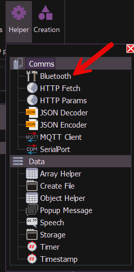

I copied the components.
I've already tried that program,
but I can't select which BLE I want to connect .
Is that the component?

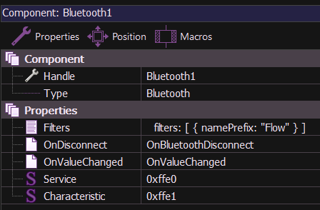

Re: Web Developer with BLE
ok I can see component and the filter now
I have an ESP32 sending a string all second.
I can receive the string in my Iphone.
Is filter like this?
name of device:
Filter?
name of device:
Filter?

I think that filter should work. The Service and Characteristic values needs to be correct for your ESP32 device.
If you call "RequestDevice", the browser should ask to connect to your device. Once connected, the "OnValueChanged" macro should be called when the data for that Characteristic has been changed.

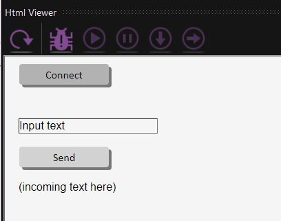

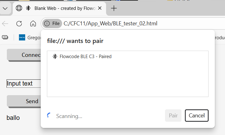

This is the HTML code on Edge working
I can receive nonstop text from the ESP32 via BLE
A small note:
with the filter
filters: [ { namePrefix: "Flow" } ]
I can connect but it's not working
And....
It's not working in the HTML viewer.
