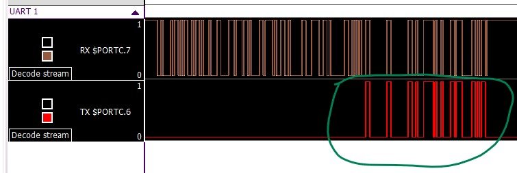

1- as you can see, on the picture, we can see TX signal even if Tx is not used

2- Still same message when push GO with ICD enabled : "The chip does not contain the latest ICD"

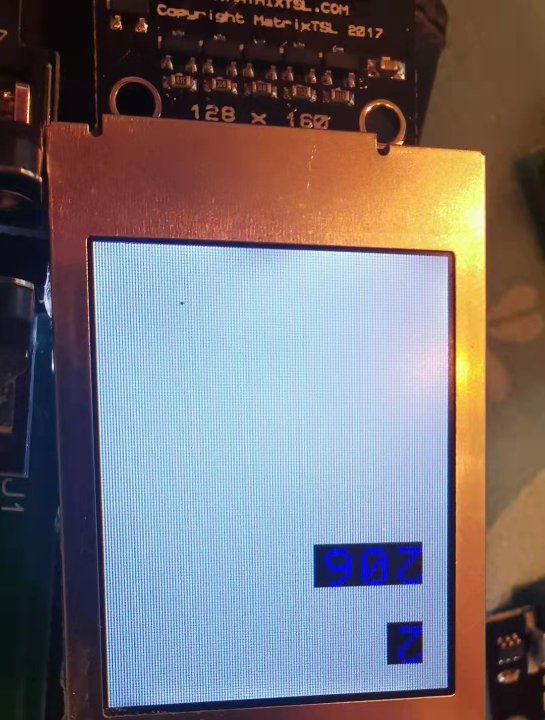

3- As you can see on the picture, I'm also using a GLCD BL0157 , there is also many bug
-Set Display orientation dont work. SOLVED I wrote 90 instead of 1 !
-Set background color don't work, as you can see on the picture, only the background color the text is updated

As for the GLCD options. The set display orientation will not refresh the display but any subsiquent writes should be in the new orientation, also the parameter values should be 0,1,2 or 3, values greater than 3 will be ignored. Also with the setBackgroundColour this will effect any subsiquent writes and so if you set the colour and then clear the display this will draw the entire display in the new background colour.

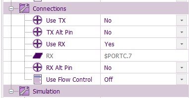

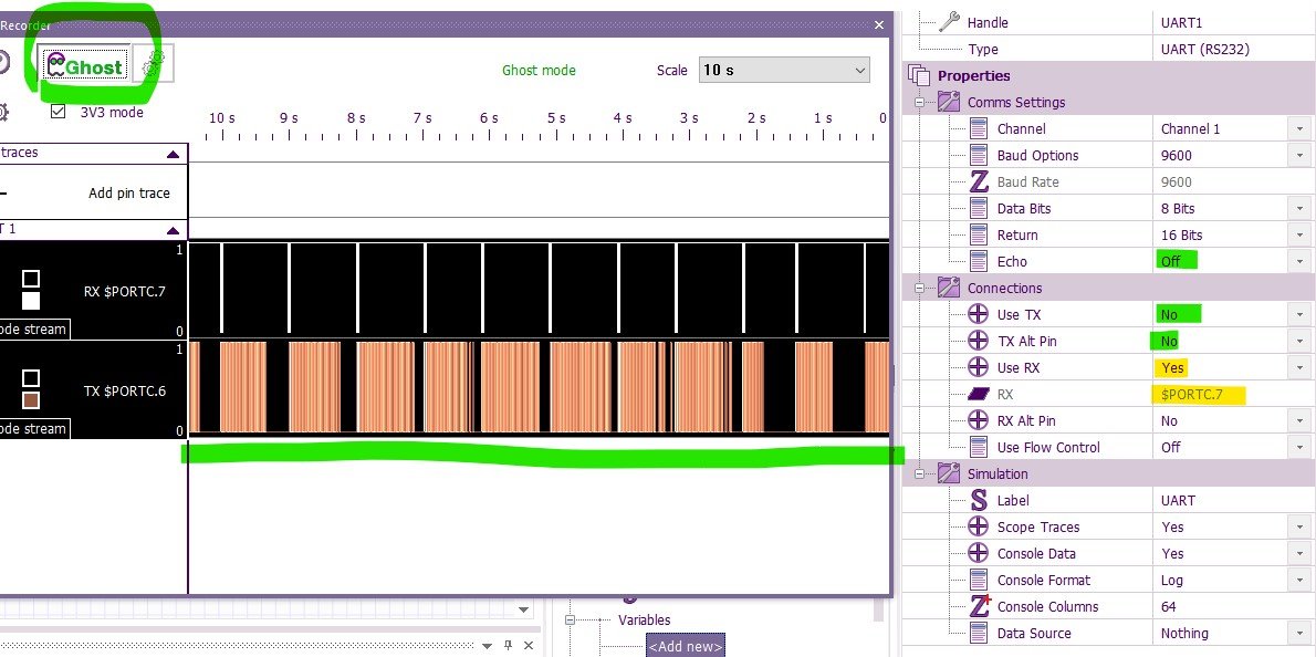

But this not solve the data on TX

It looks like the TX pin is maybe floating and hence ghost is picking up spurious data. Maybe try outputting a 0 or 1 to the pin and that should get rid of the none existant data.
