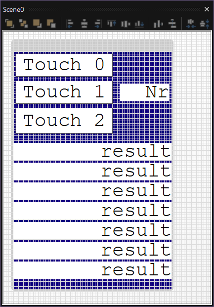

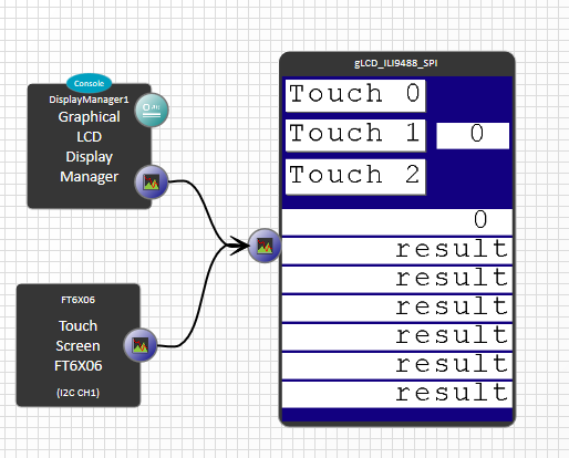

I tested the display manager and touchscreen.
It works very easily and conveniently. set the scene: It's just that I'm having a little trouble reading the touchscreen with the macro called.
Suddenly it stopped reading the correct field even in the simulation

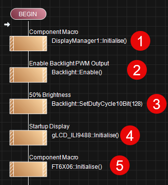

One more quick note:
GPIO48 is in use by two devices so first set backlight and then init the touchscreen, it's working.
