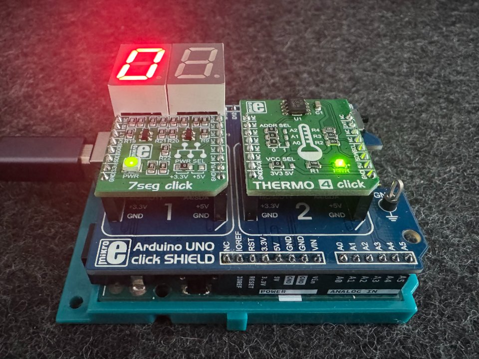

Re: Thermometer project using Mikroe 7seg Click (2x 74HC595) and Mikroe Thermo 4 Click (LM75B)
I can't make it to work. Enclosed is what I have tried...
Also, regarding LM75B, with A0 = A1 = A2 = GND, the LM75A uses the default I²C address 0x48.
I have enclosed the schematic of Mikroe Thermo 4 Click.
Try this attached example, I hope it works for you!
While debugging the I2C data, I noticed that the Flowcode LM75B component uses a hardcoded I2C address 0x92 for Writing and 0x93 for Reading.
In the picture of your hardware, your LM75B address jumpers are currently set for 0x90 and 0x91 (all pins grounded).
To fix it you just need to change your hardware address jumpers to match the software.
A0 > Move this jumper to VCC.
A1 & A2 > Keep these connected to GND.
This will change the address to match the 0x92/0x93
Best regards.
Best regards.

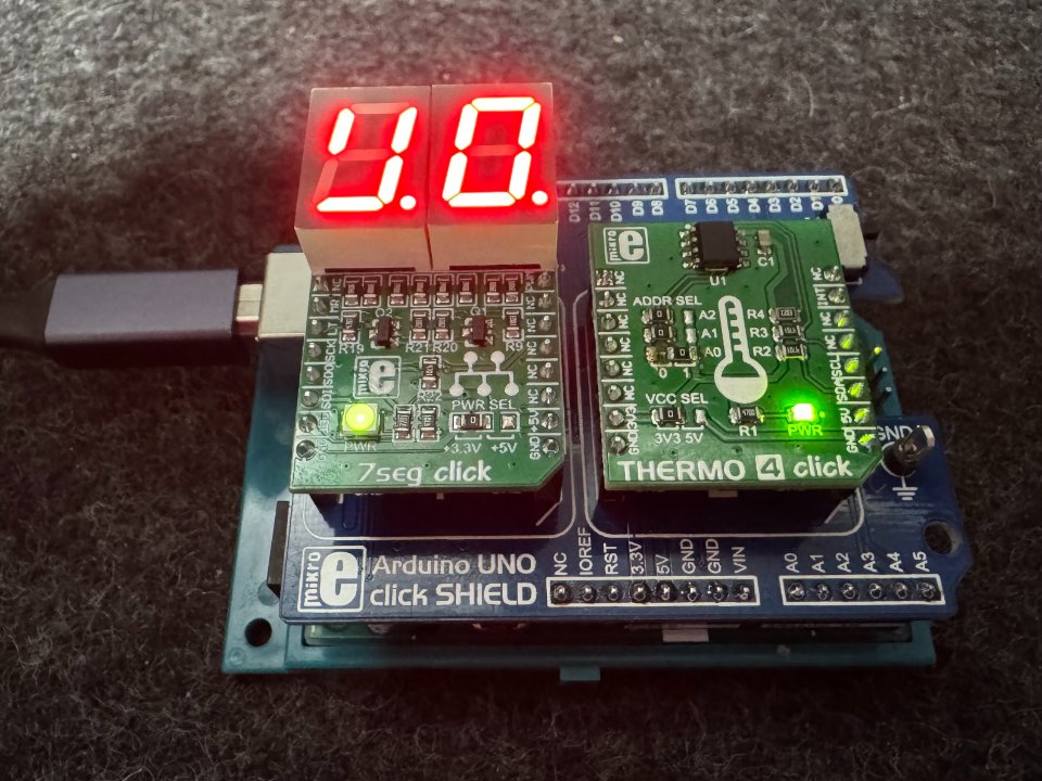

Hi Bijumon,
I have followed your instructions and moved the A0 jumper to VCC. The new setup works!
Now I have a different problem. In my earlier interactions with the Mikroe 7seg Click display, I found that:
DP is on Q0 of 74HC595
B is on Q1 of 74HC595
A is on Q2 of 74HC595
... and the other segments, of course, are not in the right order, as mapped by the component itself:
Also, I could not find the original component for download (error 404):
https://flowcode.co.uk/wiki/index.php?t ... _(Segment)
What I was using before was ShowSegments, to which I was sending the following values to obtain the numbers from the right side:
Address ShowSegment
0x7E => 0
0x0A => 1
0xB6 => 2
0x9E => 3
0xCA => 4
0xDC => 5
0xFC => 6
0x4E => 7
0xFE => 8
0xDE => 9
So the simulation with ShowDigit was working correctly, but my display shows something else now due to the reversed pins:
Do you know how to fix this? I wouldn't alter the original component, but maybe add code to change the LUT.
Andreas
Create a data array with the size of 10 (e.g., 7Seg_data[10]).
Initial with the correct byte values to display numbers from 0 to 9 based on your display type.
Then call ShowSegments as follow
Digit - 0
Segments - 7Seg_data[Digit_Tens]
Digit - 1
Segments - 7Seg_data[Digit_Units]
Digit - 0
Digit - 1
Thank you, now it works as expected!
I am posting the code for my little project, enclosed, so that everyone can see it.
Is it okay for the LM75B I2C's address to be hardcoded, or should this component be changed to allow a custom address? Luckily, in my case, I had a jumper/0R resistor which I could change, but in fixed/final designs it's hard to make changes...
