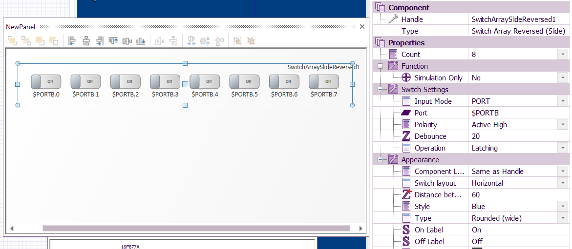

ive added the slide array reversed switches but on opening they are still left to right and no way of reversing in the properties
cheers bob

Re: Switch array
Hi Bob.
You stated
If you change Input to Mode custom, it should reverse the direction for you automatically right to left.
Now you are stating:
Unless I'm missing something?
You stated
Now I have changed it to go from left to right Note:siliconchip wrote: ↑Fri Aug 07, 2026 8:22 pmWhen using the switch array ive noticed the number and lettering go from right to left is there a way to change this to left to right
Left to right, that is what you was after?siliconchip wrote: ↑Sun Aug 09, 2026 6:24 pmive added the slide array reversed switches but on opening they are still left to right and no way of reversing in the properties
