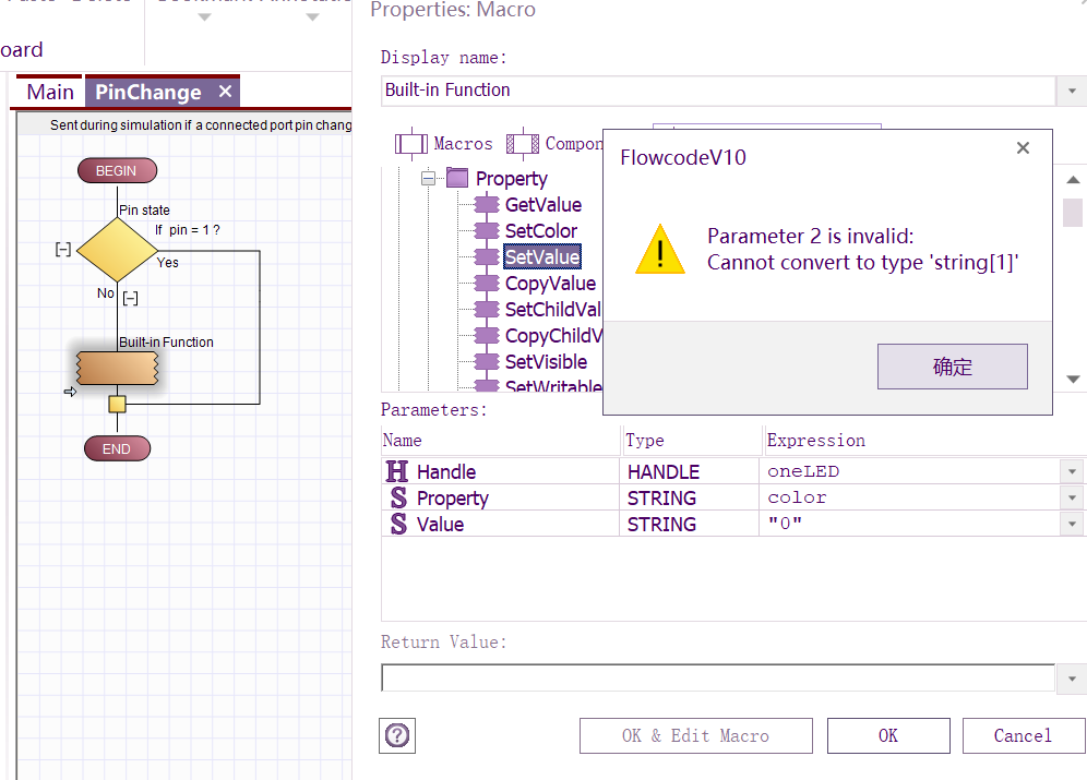

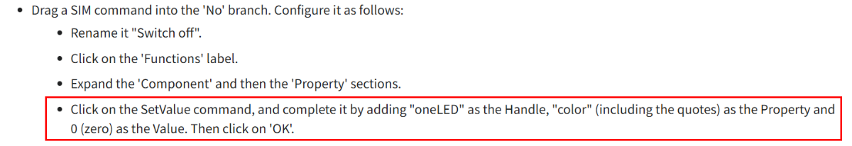

I am doing this exercise:Exercise - Create an LED Component
What's the reason
thank you

You must include the quotes e.g. "color"

And the Value property should also be a string - i.e. "0". Note that some versions of Flowcode automatically convert a number to a string in this case.

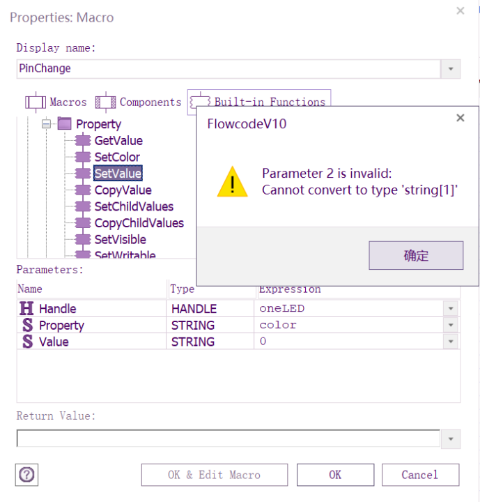

Still not working.

See Leigh's comment. The "color" also needs to be in quotes.

Okay.
Thank you so much.

I think they mean any string needs to be in quotes

Yes, unless it's the name of a string variable.
