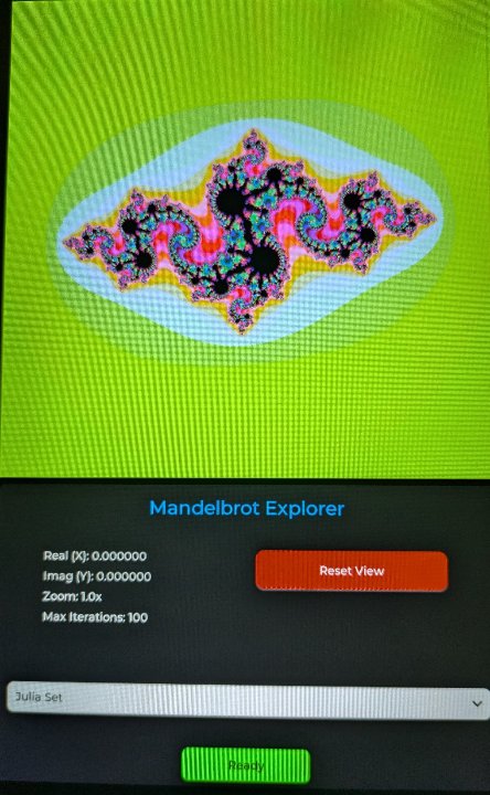

I have an esp32-p4 and for a while I've attempted to get the MIPI DSI display (interface) working with the 10.1in display. Recently I finally cracked it :-)
I used the esp32-s3 fcdx file - I've just noticed that Martin has posted a guide to the fcdx file - so I might attempt a real 'p4' one - but for now I just increased the maximum clock speed to 360MHz in the s3 file (if you are lucky you might have a board which supports 400MHz?) I then set 360MHz as the clock speed in build -> options.
Initially I attempted to draw the Graves-Stokes equation - but it was very slow (hours). So I reverted to a Mandelbrot set and then added Julia sets... Note that the p4 has a FPU - so I use floating point rather than fixed point integer (as in the s3 version)

The user interface needs a little work - but you can drag an area to magnify, or tap to change to Julia. (the dropdown - which should be full width - can also be used to toggle)
The hard part was avoiding the WDT issues - I use esp_wdt_task_deinit() to remove the WDT on the render task...
I pulled the display code from the WaveShare demo - which draws coloured bars - then alll that is needed for LVGL is a callback to copy data to the display. Here I set the clock to 20MHz - at 80MHz I think the display is working at 60Hz refresh (I got issues here - so reduced the speed - but in other samples managed to get 80MHz working - see code.c)
The LVGL code is a mix of 'design tool' and hand-coded. My main aim was to test the display (rendering is just a retro bonus) - so didn't worry too much about converting to FC - I might play with getting the display manager component to work.
You can zoom by dragging a rectangle around the area of interest - or tap to calculate the Julia set at a point (when in Mandelbrot mode)
