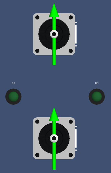

Lookup table attached to nema8 stepper motor, bug or what.?
Zoom out to see the problem.
Regards Roy.

Hi Roy
On my computer it ok .
You can look here, maybe you can take Martin's solution
https://flowcode.co.uk/forums/viewtopic.php?f=9&t=441

Many thanks for letting us know, with the latest updates this problem should now be resolved, as well as your 7-seg display problem Stefan.
