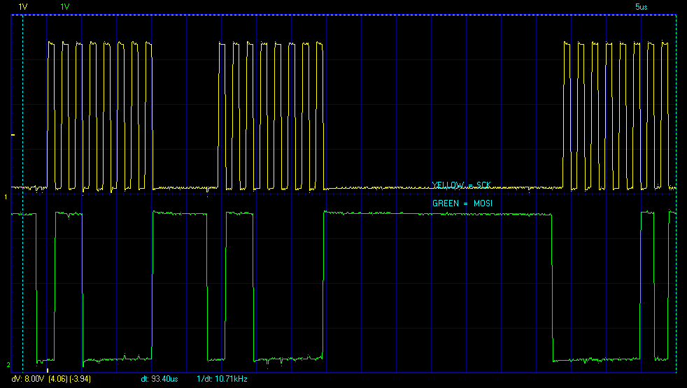

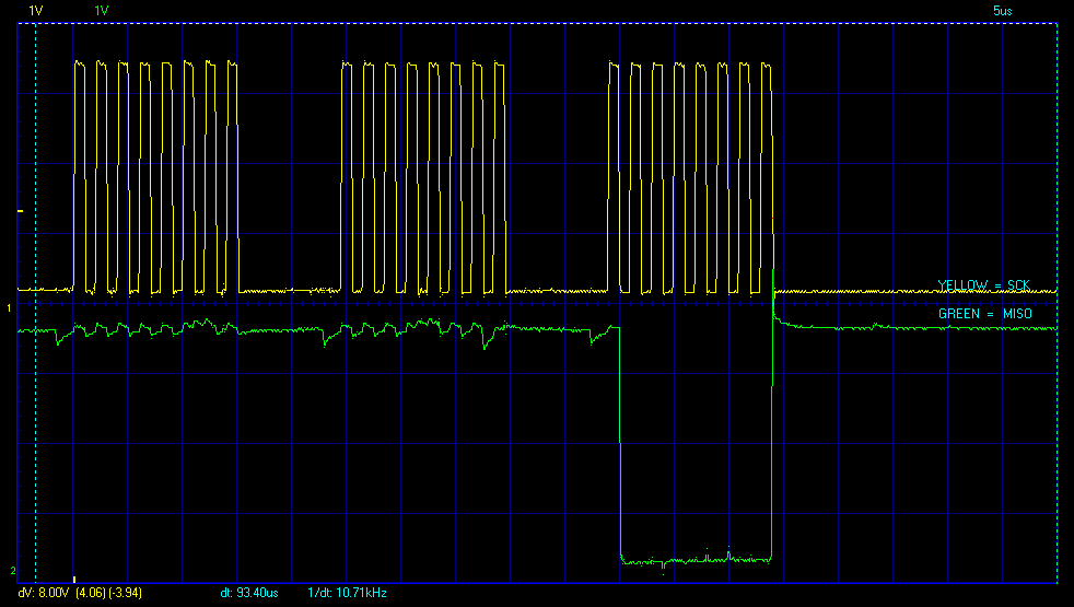

Please see the attached scope capture frames of the spi bus in the mean time as it is because these that i did not suspect the spi at the start
with regards to the slower speed are you referring to the SPI speed or the CAN BUS speed

OK, sounds good.
Note that CheckRx() returns non-zero when a new message is received.
So when zero is returned there will be no new ID and data to read.
Have you checked the bit rate of the CAN bus is correct, with your oscilloscope?

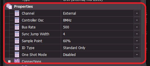

I would like to start with
1. I noticed that you stated the CheckRx() returns non-zero when a new message is received
however during this entire time I have observed it, I have only received a one or zero and it correlated the expectation that there is only
data when a one is return and no data when a zero is returned. Your (non-zero) wording brings to mined the question is there any others
state besides zero and one that I have not yet encounter but may encounter in the future

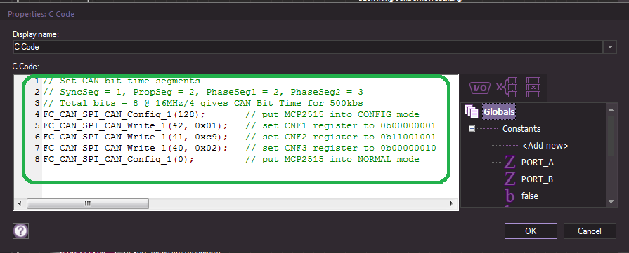

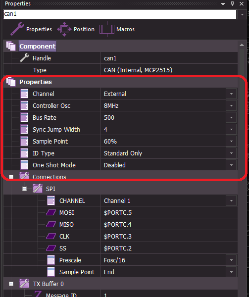

2. I have checked the timing and can confidentially say that I believe that my initial assessment of a potential bug is now stronger
the hardware checked out all good the scope measurements as well this is only true if I insert a bit of hack code that was put to together
based on various bits of research and sources and diving in deep flow code insides
It is my conclusion that the settings shown in the red block is some how not sent or sent incorrectly to the external component or omitted
during compiling suspect it is closer to the front end of things because if I include the code in the green block inside of a
custom c-code icon the CAN bus comes to life and operate I have the same story when it comes to the processors main clock which i have
to include the code in the second green block that I have had to do sins I started with flow code and got use to it, I also noted that 16Mhz
is not on the Can OSC list
could this be a bug, my platforms configuration or operators error, if I am not mistaken it is suppose to be that the settings is entered in
the prosperity block and that's it for the configuration
I am hoping you can help with my questions
Ones again thank you for your assistance time and effort it is highly appreciated
kind regards
Andre

1) CheckRx() only returns 0 or 1
2) The CAN component only supports 8MHz or 20MHz options,
so the properties set for an Osc of 8MHz will not give the expected CAN bus rate when the hardware is using 16MHz
(You could try setting a bus rate of 250 @ 8Mhz, which would give 500 @ 16MHz)
Am I correct in thinking that with your own C code setting the bit time segments your project is working well?

Good day p.erasmus
Thank you for your time and effort in responding
Your observation is correct, however it is because the component property's only gives you a selection between 8Mhz and 20Mhz
and no options for any alternatives or costume ones, which was surprising to me because during my hardware research the design using a 16Mhz
Crystal featured on a regular basses, as for the shield I selected it because of time constants and I consider it as a known good hardware design
and did not considered fiddling with it as an option until I was more familiarized with Can Bus and considering it is designed for Arduino
the the thought of the frequency not being there is even more surprising our will it only be available only ones I buy the Arduino package
Hence why I considered my platform package as a contributing factor all along as well as my lack of exposure to CAN Bus specific
Is there any technical reason that only those two frequencies are available to select from perhaps
kind regards
Andre

Hi Andre.
You are welcome!
As long as the FC component Clock setting and the HW clock does not correspond the component will result in Baudrate Errors.
I would change the HW Clock(XT) to the MCP2515 to a 8 or 20Mhz,I always use 20Mhz it give a good operation speed
It would be great if Matrix add the 16Mhz setting because many HW boards supports 16Mhz
