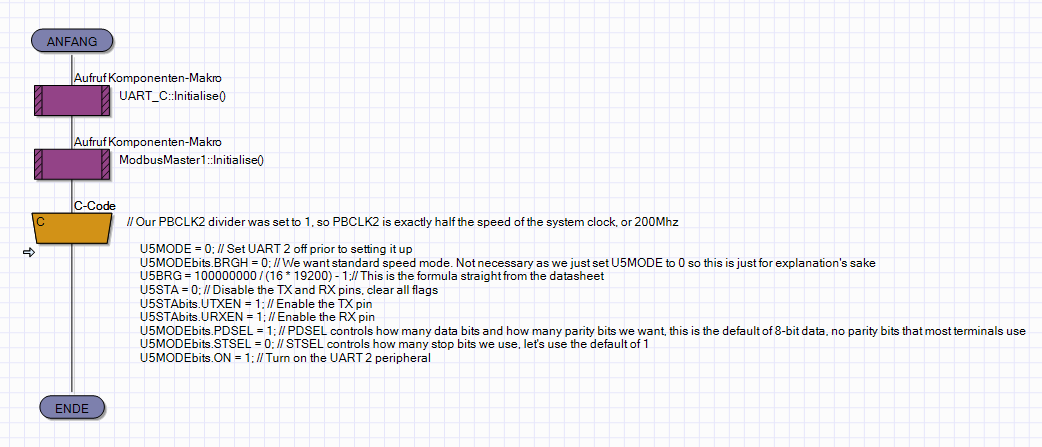

Re: Uart Parity and Modbus RTU
Hello Ben
I found the following on the page "PIC32 for the hobbyist" and tried a little.
void UART_Init()
int pbClk;
pbClk = SYS_FREQ / 2; // Our PBCLK2 divider was set to 1, so PBCLK2 is exactly half the speed of the system clock, or 100Mhz
U5MODE = 0; // Set UART 5 off prior to setting it up
U5MODEbits.BRGH = 0; // We want standard speed mode. Not necessary as we just set U5MODE to 0 so this is just for explanation's sake
U5BRG = pbClk / (16 * 38400) - 1;// This is the formula straight from the datasheet
U5STA = 0; // Disable the TX and RX pins, clear all flags
U5STAbits.UTXEN = 1; // Enable the TX pin
U5STAbits.URXEN = 1; // Enable the RX pin
U5MODEbits.PDSEL = 0; // PDSEL controls how many data bits and how many parity bits we want, this is the default of 8-bit data, no parity bits that most terminals use
U5MODEbits.STSEL = 0; // STSEL controls how many stop bits we use, let's use the default of 1
U5MODEbits.ON = 1; // Turn on the UART 5 peripheral

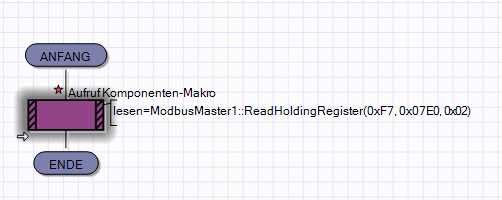

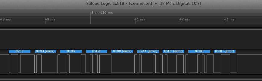

I use this as a macro
I can use the Modbus commands at the moment.
my sensor also responds.
As I understand it, the individual bytes that my sensor sends in response are automatically stored in the receive buffer.
Can you give me a short example based on my data?
this is being broadcast 0xF7 0x03(error) 0x07 0xE0 0x00(error) 0x02 0xd0 0x1f
this is received this is received "28.23926" this is °C
how do I get the value from the buffer.
I read it from the PC software of the sensor.
I hope you get it right.
I think the UART settings can be extended.
Thanks a lot
