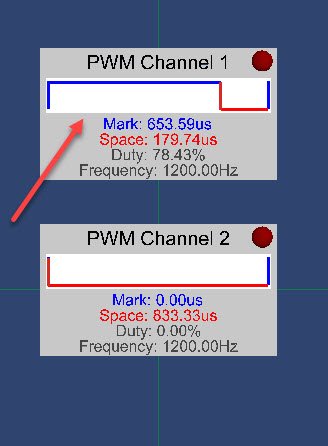

PWM on PIC16F1938 has some issue if I adjust the duty cycle on Channel 1 then the duty cycle on Channel 2 changes
the pins in the properties correspond correctly Channel 1 RC2 and Channel 2 is RC1 .

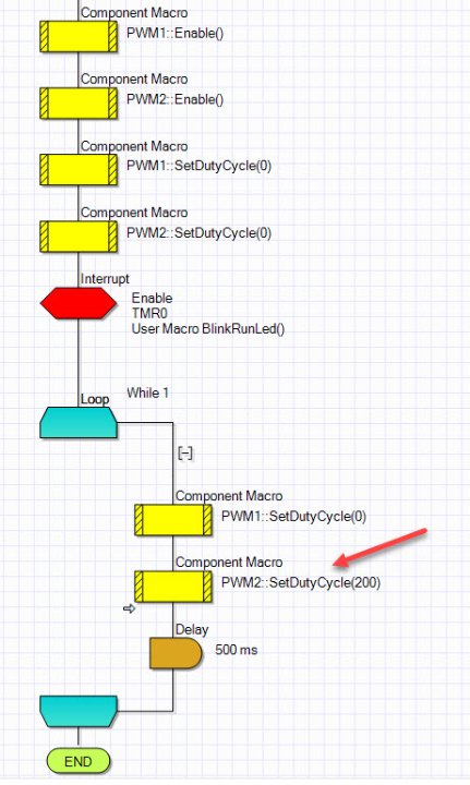

Here is the FC chart in my opinion CCP1 is Channel 1 and CCP2 is Channel 2 setting Channel 2 Channel one DC changes even on Hardware
Chip pins is CCP1 = RC2 and CCP2 = RC1
