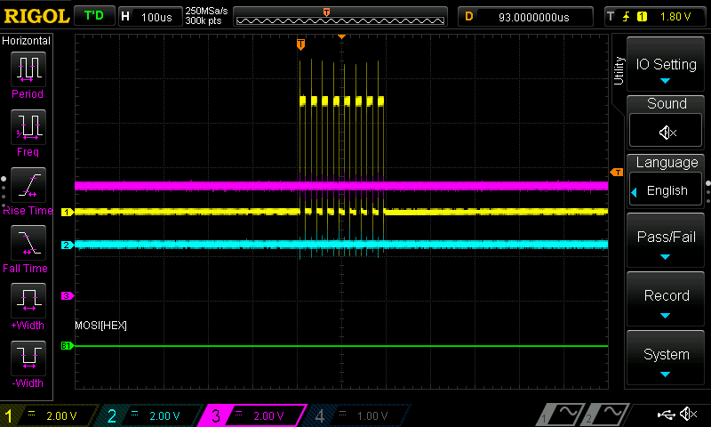

Hi Team.
I need help to understand and work with the new SCADA API,

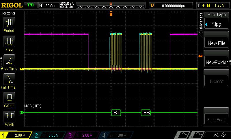

I have made a simple FC Chart using PIC16F1938 and transmit a SPI Transaction it woking as I would it should .
As you see here I have a decent Clock DATA and a CS line that is working ,the decoder can decode this and it decode the 2 bytes as 0xB7 and 0xBB
exactly as the code is written to output.
Using the exact same Chart with UNO scada the only signal/trace that is some how correct is the ( SCK) clock (yellow trace)
the MOSI(DATA)blue trace has no output and the CS(purple trace) is doing somewthing very strange far from a CS signal.
I am attching the FC chart if you can please show me what I am doing wrong in the new SCADA API I will be very happy as it has stopped to work with me .
Appreciate your help I am missing something in the new API the reason things are not working :D

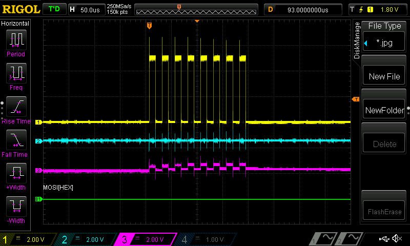

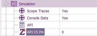

Hello Peter,
The bouncing of the CS pin means the pin is probably floating and isn't being driven. The CS pin is assigned via the SPI component simulation properties. If the setting is not there then please can you post your program and I'll investigate for you.

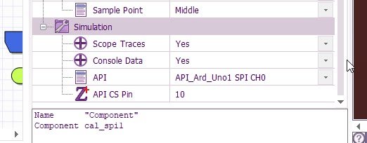

Sorry didn't spot the file link at the bottom.
I've just found a problem with SPI Master which has now been solved and here is an example using that.
SPI_API_Slave_Demo.fcfx
(9.6 KiB) Downloaded 539 times
I guess you are wanting the CS pin to be on the API Slave Pin 10, currently it is being assigned to pin 0 as your calling the CAL SPI component in your program.

Ben
Thanks setting the pin in simulation does solve the floating issue
but CS is NOT working and I have NO MOSI signal

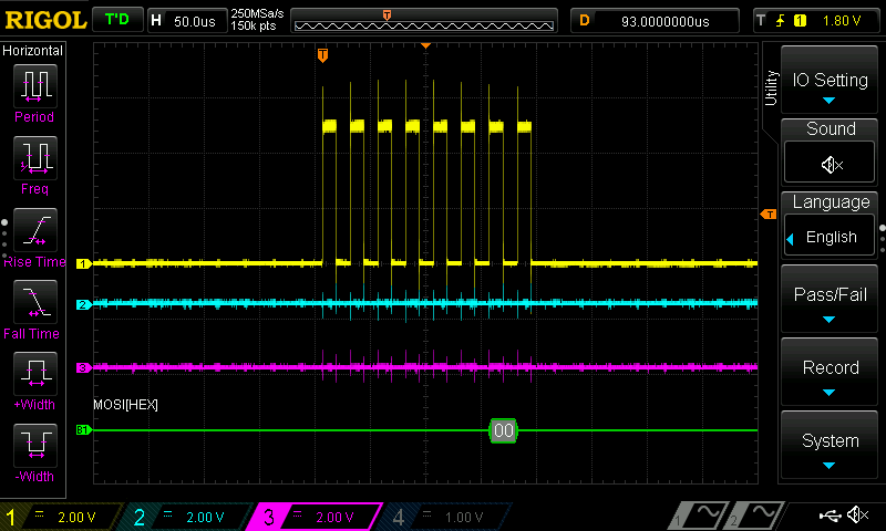

Post by p.erasmus »
Your example has no CS pin activity and no MOSI signal.
I do not know what is missing all I know the SPI and I2C with the old injectors worked perfect :D I knew which components to link to which ones to have a working system,but now I have no Idea what to use and what to expect :D
