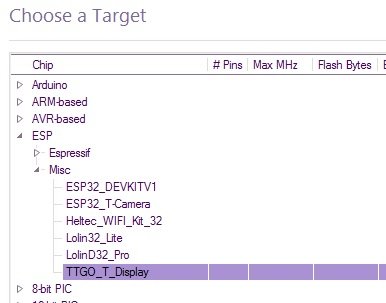

I saw your answer but which component should I choose among the ESP32 cards that I see in the ESP32 folder ... ?? Thanks Alessandro.

We have a definition for the board you can select.
