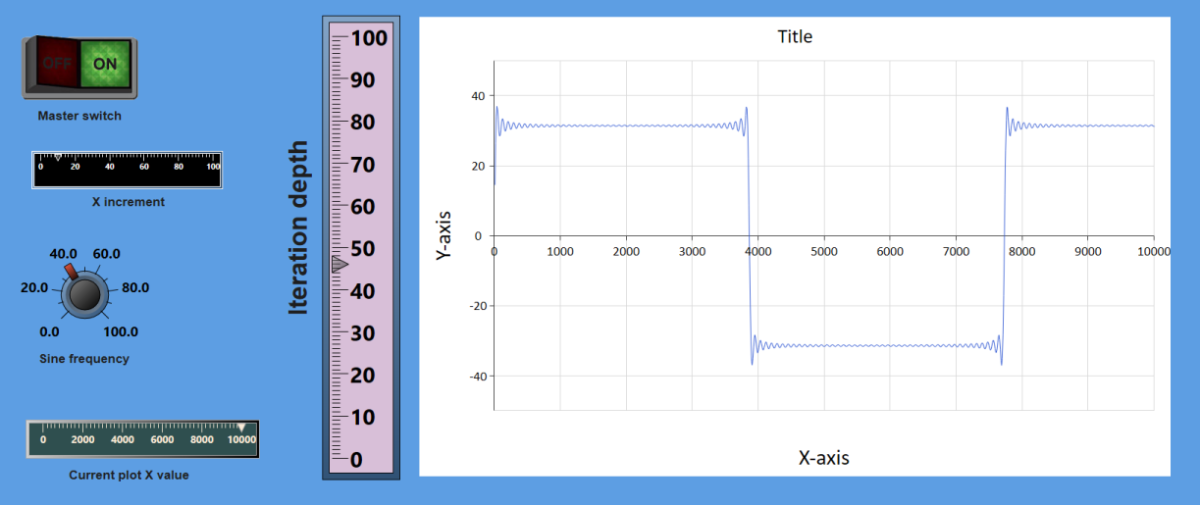

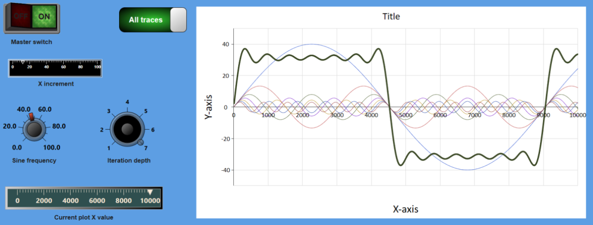

During the development of the v9.2 update I created various projects to test the updated features. I thought I'd share these two which I developed to test the graphing improvements.
They both show how a square wave can be approximated by adding together a series of sine waves. The "X increment" slider effectively sets the resolution of the graph - lower values give better resolution but are slower to plot (when X increment = 1, values for all 10,000 coordinates are calculated and plotted).
I hope you find these interesting or useful.

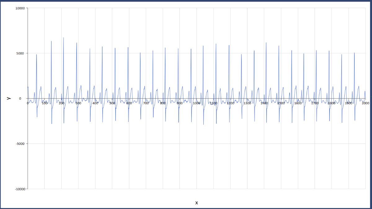

Yes it's a big help, how to use the graf. I will try to display my EKG (heartbeat).

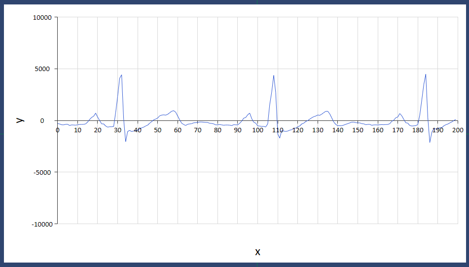

Re: Fourier series graphing tests
Post by stefan.erni »
Hi Steve
The chart is working nice together with Bluetooth to show ECG.
As a sample: Chart with 2 seconds or 20 seconds.
