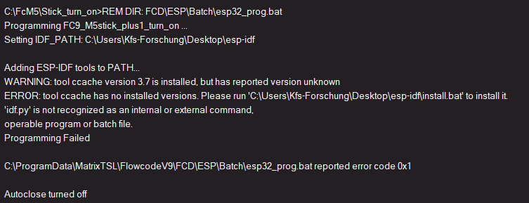

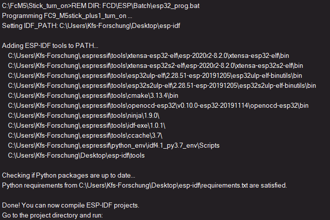

A problem with the ESP32 and FC9. If I compile, sometimes I get an error, sometimes it's ok with the same program.
but mostly error.... It's on all ESP32 board's

Re: ESP32 sometimes error, sometimes ok
That's very odd I've not come across that problem.
Are you running any antivirus or firewall software that may be interfering either flagging things as false positives or preventing things from running in a timely manner?
If not then It might be worth uninstaling the ESP toolchain and reinstalling and hopefully that will resolve the problem for you.

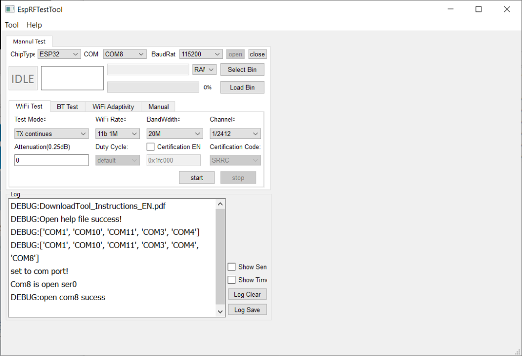

It's not a big problem. it's not often and I press one more times.
In this way I found a nice zip file in a zip file with a program (EspRFTestTool_v2.8_Manual.exe) to flash bin (from FC9 created) direct in a ESP32
This is a big help to programming a serie of ESP32 very fast.Like the MPLAB X IPE v5.40 from Microchip (for PIC32)
In this tool for the ESP32 is much more included like Power Option for the RF part ....
ESP_RF_Test_EN
EspRFTestTool_v2.8_Manual.zip
https://www.espressif.com/en/support/do ... d%5B%5D=73
