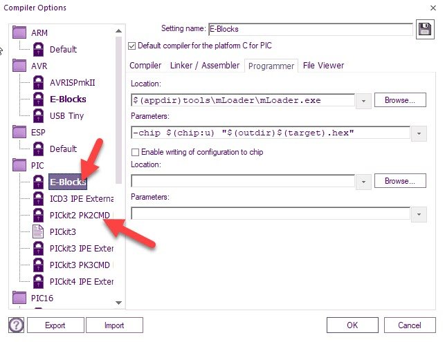

Last week I was working on a project with a Pic16F88 used my EB board to program and all ok.
Today I will continue and suddently tha compiler ask for a PIcIT2?? The only thing I have done is perform an update via help.
Please how can I program again with EB board.

Did you check under Compiler Options >> Programmer that the EBlocks is selected and not PIcKit 2
and on the top makesure the default hook is on

It was the problem, now solved. Thank you very much. :D But why it suddently has change in all my PC after update??
