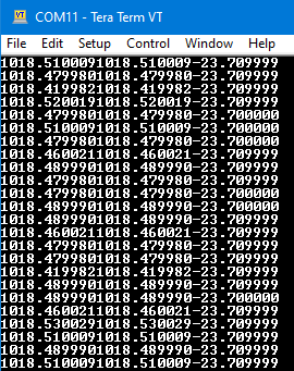

I have a BME280 Module & the BMP280 component working is for me.
I can see the correct Pressure and Temperature.

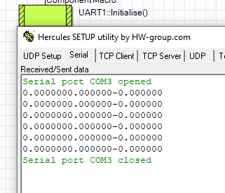

Re: BMP280 wrong setting SDA and SCL for arduino in V9.2
I can confirm that using device BMP280 we got zero (0) as output.
Is there someone else how could check ?
Using BME280 COmponent I get "stange" ASCII signs as output
here you are.
Thank you for help in advance
here you are.

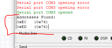

Your flowchart is working for me:
Can you try the attached sniffer, my results for the BME shows:
Perhaps the Ardunio is not seeing your device, or the address is incorrect?
- IC2 Address Sniffer Ardunio UNO.fcfx
- (21.29 KiB) Downloaded 1171 times
- (view online)
Port is detected, but the output is still 0 from sensor.

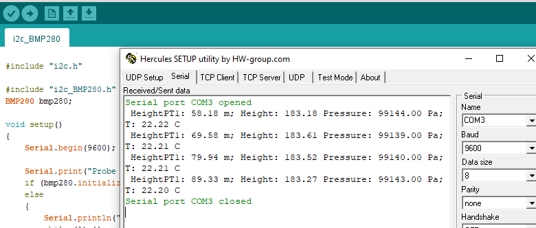

I just tested it using sample code for IDE and it works ... so sensor is OK.

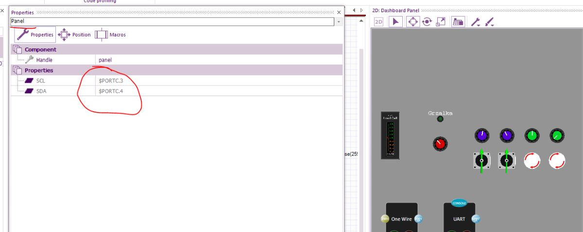

I have found something strange, If i click in gray area on Panel I got information like attached, SDA and SCL are still wrong (D3 and D4)... but in HX711 properties are correct (D4 and D5)
Do you have more idea what could be wrong ?
