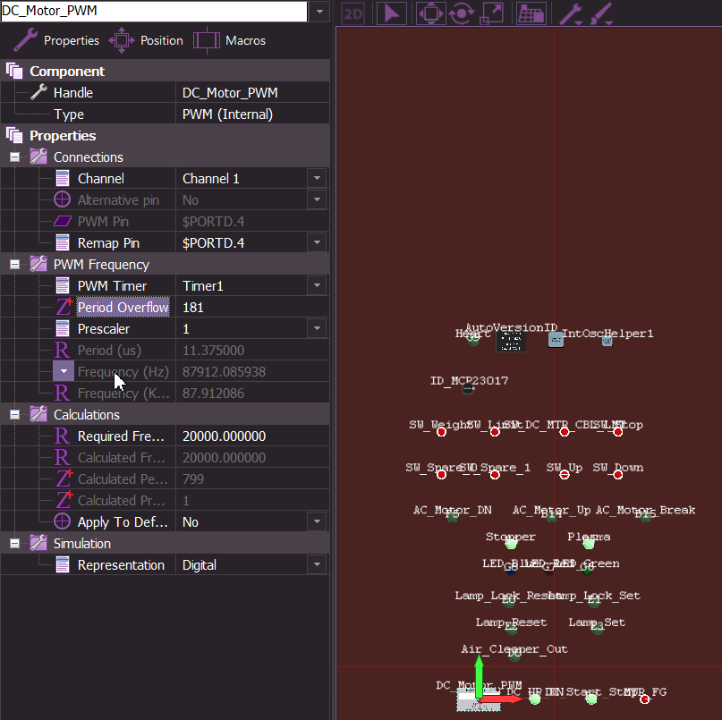

I am working with PIC24FJ256GA406.
The motor is controlled using PWM 10-bit Mode.
When the program is saved and reopened, the period overflow value of PWM Frequency of the component property returns to 181. If you change the value back to 1023, it works normally.
Is there any way to fix this?

Re: PIC24FJ256GA406 PWM 10bit mode Frequency fix?
Thanks for letting us know. Investigating this for you now.
Edit, should be resolved for you now with the latest library updates. Thanks again.

That's work well.
Thank you.
