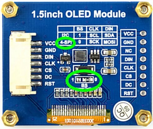

Hello!
The ssd1327-Component already exists inside flowcode v9, but with I2C. For beter performance it was nice to have a component with SPI. For more text and graphics, the resolution of 128x128 is much beter than 128x64. The gray scale could be a factor for all pixels at the same time, setup before writing to the oled. What do you think, how much sram is needed for this one?

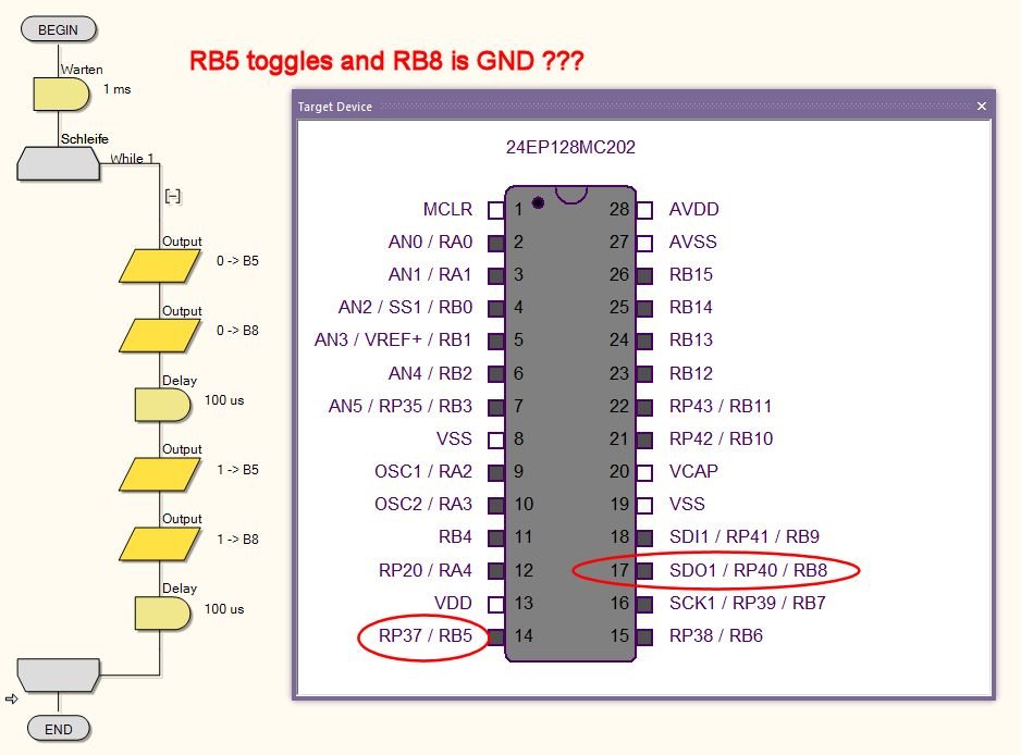

Hello Ben,
I downloaded the component files and tries again. B8 is no signal coming out? B5 is working!
The other pins described a post before are not working, too.
Please have a look to the attached picture. It`s only a simple program.
Any ideas?
Any ideas?

I've been looking into this one for you and I can't seem to replicate the issue on 16-bit EP hardware. I've also looked through the datasheet and there shouldn't be anything specific on the upper PortB pins that is causing a problem.
To rule out some form of CAL issue can you try this with a C icon and see what happens, all the PortB pins should toggle on and off together.
If that works ok then please can you also try this.
