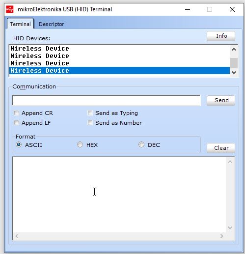

However I am not sure if the PICO supports USB HID ,we would like to emumerate it as a keyboard ,I have placed a USB HID component and did the settings as I think it should be (although I have concerns about the decriptor file) the PICO never show up as keyboard in windows I am using the mikroE IDE HID terminal to see if the pico did enumerate ( using this HID terminal in the past with various PIC's I know I can trust thisterminal :) )
Attched the PC chart and a screen print of the HID terminal

sorry for the delay, and we don't currently have any USB support for Pico
